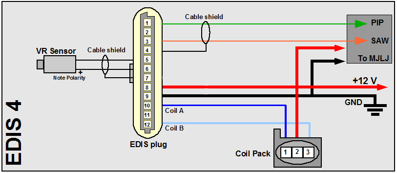

Is this a valid set-up ?
New Diagram
New Diagram
MartinM
Posts: 433
Post by MartinM »
Looks good to me....
