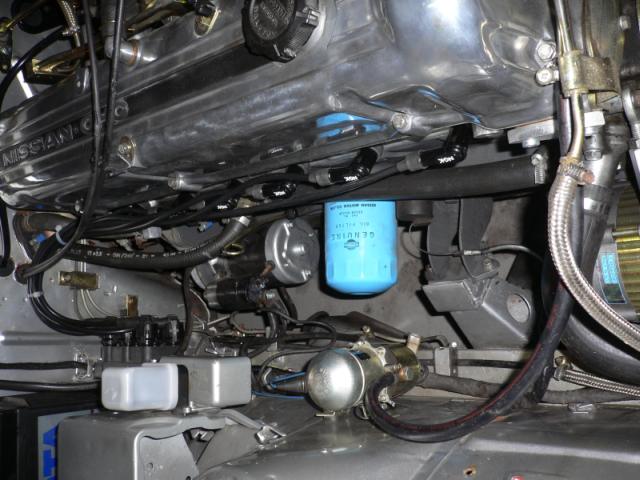

Ford coilpack with custom  ignition wires.

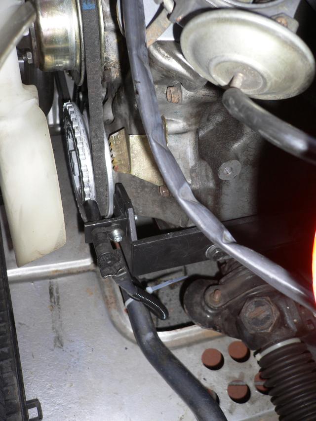

Custom VR sensor bracket.<br />Trigger wheel  is from trigger-wheels.com

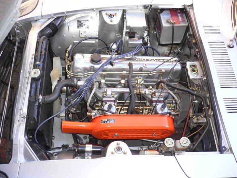

the actual state with original engine
original  engine
original engine
