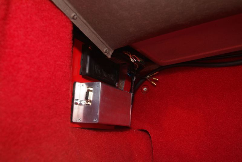

Forgive my ignorance but life got in the way when I started fitting my Megajolt :oops: . All the ironwork and wiring is all done, and we're looking to get the beast fired up next Monday.
Anyway, a quick question, how do I know what software version to download for my Megajolt? I bought mine of the shelf complete from Brent in May 2006, but never got as far as connecting it.

You are likely on 3.0.0 firmware. Just download the corresponding 3.0.0 configuration software and you should be off.
Note, the 3.0.0 software has some problems with certain usb-serial adapters, so best is to test it on a PC with a standard serial port.
Verify it all works, and then you may consider upgrading to the 3.2.1 firmware.

and if you do have to use a serial to USB converter, buy a belkin brand. seems to have a 100% success rate, unlike ebay-sourced no-name brands.
