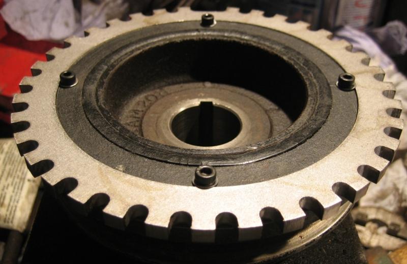

Enough about the engine. More about the MJ. Well, trigger-wheels.com did the honours for the EDIS bits and bobs. MK1 coil, 5.125" wheel with 1/2" hole, used plugs and EDIS module. Arrived safe and sound.
First off was making the crank pulley and trigger wheel. The pulley I have is off an MG Metro, so it's of the cast variety. I knocked the old trigger wheel thingy off the inside of it, and put it on the engine (which was conveniently located on the bench - man would I hate to have to do this with the engine in the car). Did some quick measurements, and went off to university to use the CAD software. Made a model of the pulley in situ on the cover and had a look at clearances.
I came up with this design of trigger wheel mount...
...which fitted onto the pulley like this:
Made out of two parts, it would have a boss bolted to the crank pulley, to which would be welded the trigger wheel. Sounds complicated, but it gave me the clearance (I thought - more later), and meant I didn't have to worry about where I put the holes. I could just make the boss and drill & tap the pulley, then weld the t-wheel to the boss in the right place once I had the sensor mounted.
It meant I had to take the hole in the trigger wheel out to 70mm, which I managed to do on the lathe at University (Ta Keith). Also did the boss, but didn't take any pics.

I had previously stamped a helpful "9" into the 9th tooth after the missing tooth. I lined this up with the centre line of the sensor and marked the trigger wheel against the crank pulley with a Tipp-ex pen. Took it all off, and used a centre punch to put a permanent mark, right where the boss joined the trigger wheeel (marked with the arrows labeled "WELD IN HERE" on the pic above). This made the previous sliding fit between the two into a bit of a bodged interference fit, so they stuck together. I took this opportunity to double check it all lined up properly, then have a cup o'tea, then triple check.
To minimise any risk of distorting the trigger wheel when welding it to the boss, I roasted the two at gas mark 6 while I had my lunch. Finished lunch, lined up the centre marks (good welding gauntlets required here) and MIGed the two togeher with 3 small beads in between the mounting slots. Once it had cooled, I bolted it all together and got on with the rest of the engine build.

So that's how I did it. The big question is, 'would I do it like this again?' The answer to that is: 'er maybe'.
The clearance between the timing cover and the boss was always going to be tight. Making the boss took a while - turning it down, milling the slots, counterboring them etc. And in the end, it didn't fit. If I didn't have a lathe handy, and a bit of scrap bar, I would have been in for another wait while someone else made one up, and it would have been just another bill. In short, it would've been a right hassle if I didn't have the benefit of 2 generations worth of amateur engineering facilities at my disposal, as well as a University workshop. If you want an easy install, weld the sensor to the engine mount plate that bolts to the gearbox, and have someone turn a shoulder onto the outside edge of the pulley. Much easier I reckon.
However, it is quite a tidy install. Everything is quite compact, and nothing looks like it really shouldn't be there. Making the mount in two pieces was a good idea I reckon. It really took the pressure off when I was drilling and tapping the crank pulley.
The only really awkward thing is looking at the timing marks now they've been bent out the way and someone has put a sensor right in front of them. That would be a right bugger if I still had a distributor. :D
