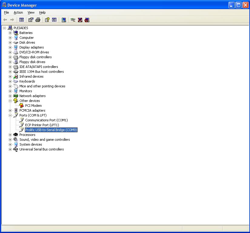

do you have access to another computer/laptop? install the configurator on a desktop computer (if it isn't already) or one different from your current "problem" setup. hook everything up and make sure you have the correct COM port picked in the Configurator Options.
i.e. Right-Click "My Computer">Properties>Hardware Tab>Device Manager button>expand the Ports section. i've got both my onboard COM port available as COM1 and my USB-to-COM cable available as COM9. then just set accordingly in the Configurator Options.
i've attached a visual for the non-auditory :wink:
