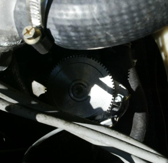

Firstly - why do you loose the 2 teeth signal when you install MJLJ ?
Do you remove the wheel that these two teeth are on ?
If so, can't you keep it - and mount the 36-1 wheel outside it, and have both ?
If not - I have a modified distributor with a 72-2 wheel. And it works nicely. I got it started yesterday. But it seems to be doing just fine. I know there's at least one more user here - Alexander - having a modified distributor as well with a 72-2 wheel.
