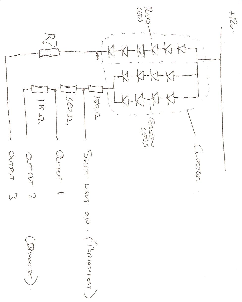

Right i have done a bit of testing on getting a different brightness of the LEDs. At the moment i am just trying the best way of changing the brightness of the bulbs using a 12v supply and some resistors, not actually using the Megajolt. I am using the PSU out of a desktop computer(yellow and black wires are +12v and gnd respectively).
Firstly i tried getting the cluster to work without causing any damage but the resistors i used must of been to higher value for the LED to operate, that and the batteries i were using were too flat. In the end a 360 Ohm resistor worked a treat with the PSU to get both colours working but not at the same for some reason, probably because one of them robs more power/current than the other. Anyway i then put 2 x 360 Ohm resistors in parallel (equals half the value of one) and no obvious real difference was seen in brightness.
I then read on tinterweb that the best way to alter the brightness for an LED would be to use PWM (Pulse Width Modulation). I think this will be well OTT for the type of thing i'm after really.
I then used a 1K Ohm potentiometer (not as a variable resistor) and connected the output to one side (colour) of the cluster. By adjusting the Potential difference a very clear difference in brightness could be managed but only for a small amount of adjustment. So this has given a basis of what direction and values i can start using.
- Posts: 704
- Location: Fareham, GB
A bit more testing and i'm happier with what values of resistors i wll be using. At the moment its going to be 180, 360 and 1K Ohm. So max brightness would be when the current is going through just the 180 Ohm, medium brightness would be 180 + 360 Ohm and dim would be 180 + 360 + 1K Ohm. Although i am tempted to drop the 180 lower to make it a little brighter. The best way would be to drive with them on and see if they distract me while driving. Think an optional on/off switch would be good idea at this point and maybe a daytime/night mode a bit later on.
I tried just putting the cluster to 12v without resistors and they hurt my eyes they are that bright. I only flashed them on as i didn't want to blow any and it cost me another £5. Very impressed
I am playing with some LDR circuits to have auto headlights and maybe i could have the daytime/night mode incorporated into this, maybe.
- Posts: 704
Success, i set the the output options and shift light to low levels of rpm for testing and the shift light now has 3 different brightnesses of green and a bright red just before the rev limiter. I'll try to get a circuit diagram of how i have done this if anyone else is interested but so far it works a treat

hopefully here is the circuit diagram if its worked properly
R? - i have not put a resistor in line with the red leds as yet as they seem to work ok without. A 100 Ohm value would probably be ok for some protection.

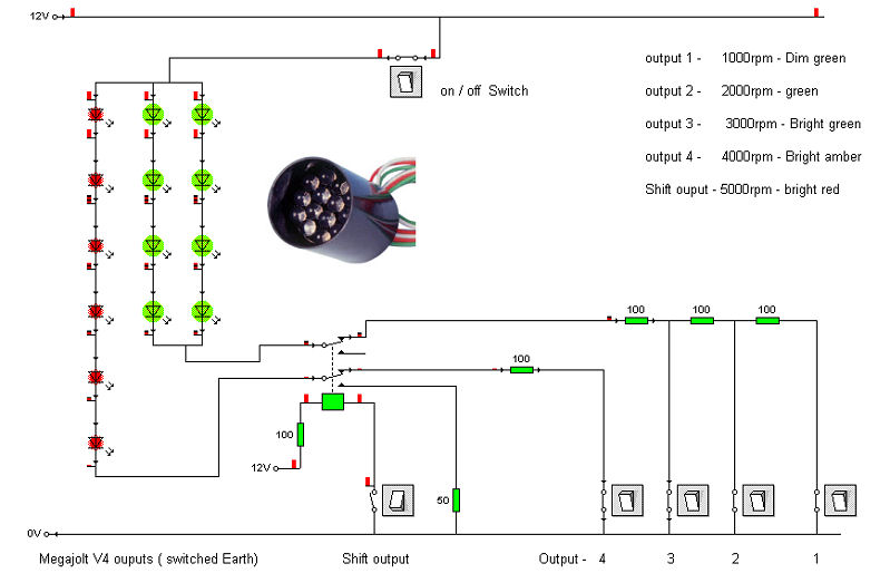

I have ordered the LED cluster today and had a little time to think about it. Building on the above circuit it should be possible to get the green leds to get brighter, then the red come on at the same time to give Amber, then for only the red to stay on brighter for shift. - will have to play around with the cluster some switches and a selection of resistors - This is the idea I am working on.
Paul
Paul
- shift light.jpg (62.68 KiB) Viewed 19734 times
