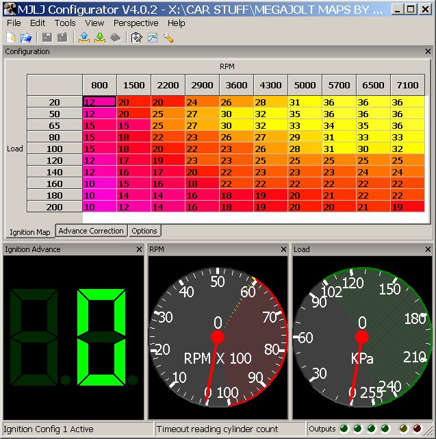

I put this in to a A4.0.2 Format as I am looking for base line maps for my Supercharged project and this looked to be a good starting point as the NA portion looks similar to my NA pas at the moment. I am trying to build a library of just Forced Induction maps to study.
SC MINI.jpg (106.41 KiB) Viewed 10349 times

Many Thanks for posting this map,this has sorted so many of my running problems
I no longer feel like scrapping the little rust bucket :D
