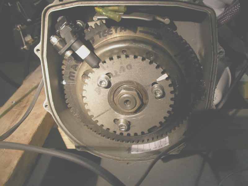

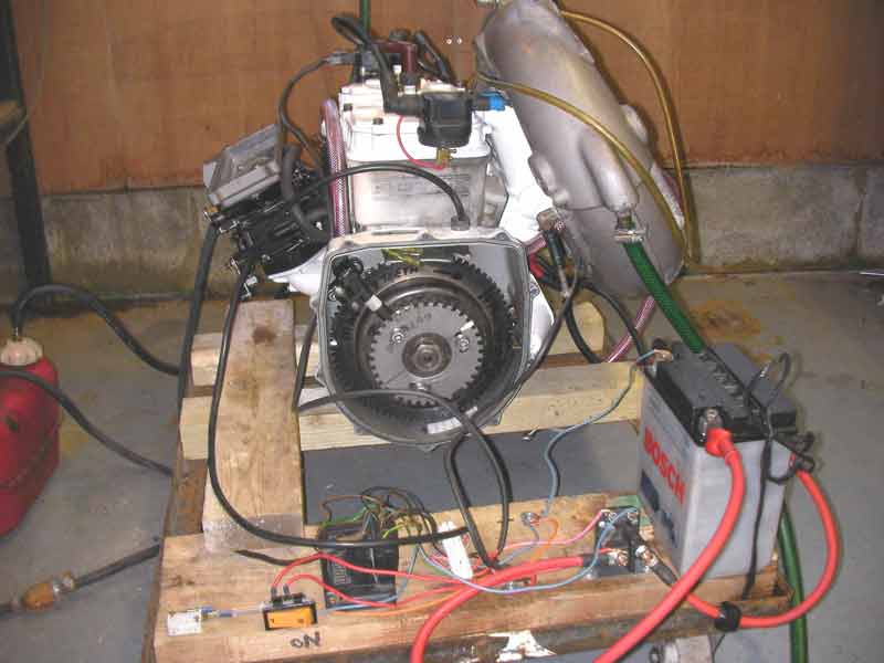

Today I had the Rotax engine running for the first time on a stand with the standard EDIS4 set up. 4.5in trigger wheel and VR from triggerwheels. The sensor has gone in unbelievably neatly as if done by the manufacturer. So far I have no MJL fitted so firing at 10BTDC.
All seems OK at idle but it is going to be tricky setting it up as 101 other things have also been done to the engine & carbs and it seems I will pioneering the ignition map on this engine (or indeed any 2 stroke).
I am getting a blurry strobe picture. Not sure if it’s the cheap in-line light or a genuine unsteady spark. I seem to remember reading about this on this site but cant find it again.
The usual set up is for this engine to fire at 21BTDC at 6000 rpm. Can anyone suggest a good starting place for idle timing. Hope to get some pics of soon of this setup.

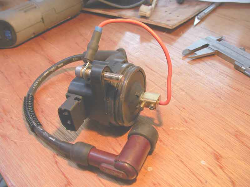

EDIS4 on a rotax jetski engine. Modified volvo S40 COPs to be coil near plug.
Test Bench
Test Bench
Timing wheel
Timing wheel
Volvo s40 COP with the bottom cut off
