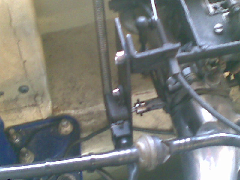

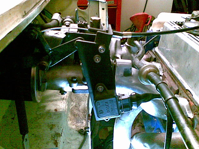

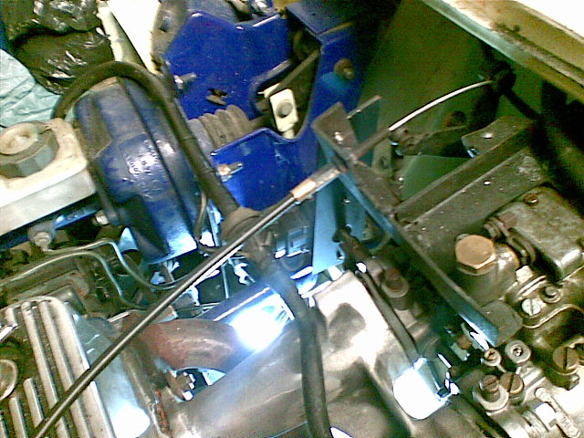

hi Heré is my setup from one DHLA 48 on a mini. The tps came from a Opel/Vauxhall 2liter
hope it helps
Dave

Thats great Dave, thanks. Dont suppose you've got any close up pictures have you?

Post by davep »
I will take some better photos at the weekend
Dave

Post by studarude »
You sir, are a star. :D
Many thanks!

Post by davep »
Hope the Photos will help you
Dave
