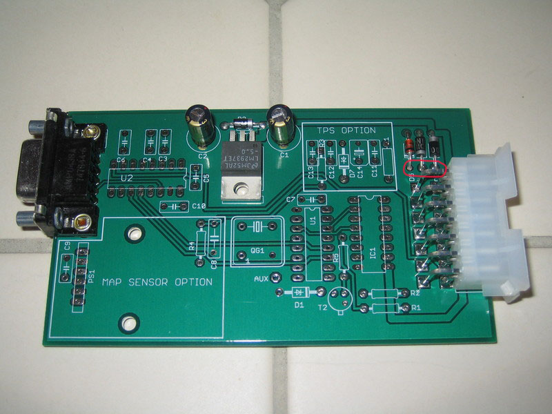

While waiting for the new fix/update for v3, I installed a hard rev limiter module. Whilst doing, I soldered a thicker gauge wire to the pin on the Molex where +12V comes in.
Appearantly my soldering wasn't good here. So most of the strands had come undone, and was lying up against the components marked with read in the image below. Some strands were off course still on the Molex pin, so there was 12V on all strands.
Now, what can I have fried with this 'operation' ?!
The unit no longer works, and doesn't communicate with the Configurator any more.
I'm hoping that what I have damaged is replaceable. But, I need help in figuring out what components I most likely need to change now.
But soon after I had uploaded new firmware I suddenly heard spark sounds and a fried smell came out.
I turned off power as soon as I could. When I opened the case I found the cause.

Ouch- that does sound bad. You will want to replace D2, D3 and D4.
See schematic here http://www.autosportlabs.net/asl_dist/m ... v3_sch.png) and the BOM here http://www.autosportlabs.net/asl_dist/m ... v3_bom.txt.
Unfortunately, It's likely the PC board traces have been vaporized as well- you may need to manually patch up / re-route the traces using jumper wires.
One thing you could do to verify if the controller is basically 'alive' is to bypass that part of the power supply circuit and feed in voltage from a 9v battery right into the input of the voltage regulator. If it works then it holds promise for repair.

And, an additional question:
I've now inspected the board. All traces look solid.
But, when doing so - it seems to me that D2 and D4 already are wired directly to the +12V pin ?!
The trace on the underside looks to me to connect the +12V pin and the same side of D2 and D4 that I had marked were in contact with the strands in the initial post.
Could they really have been damaged then ?
And, how about D5 ? That's the third one that the strands likely were in touch with on the side closest to the Molex.
Thanks in advance.
Thanks in advance.
I'll check later to see if the controller is alive.

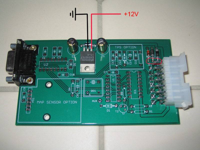

Well, I fed power to the voltage regulator as per the enclosed image.
I at the same time connected it to the PC and started the Configurator software. Nothing. COM port was the correct one.
And, all traces look as before the incident.

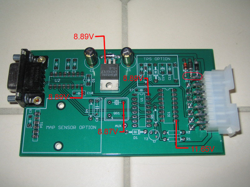

Does the voltage regulator output 5V? If you verified the voltage regulator is outputting the proper voltage to the various components (oscillator, processor, etc), then perhaps the original shorting problem caused 12V to be injected into areas of the board where it could not be tolerated, damaging multiple components in the process.
Double check your regulator is outputting 5V and let us know.

Patriq, from you measurements it looks like your voltage regulator isn't working properly/has blown. You can find data sheets off the interent for most components. For the max232 you can find one here http://www.datasheetcatalog.org/datashe ... max232.pdf and it shows that max voltage is 5.5v, so looks like that may have some damage too.
The best thing to do is defo change the voltage regulator first with all other chips off the board and double check your still getting 5v then add new chips. Most of the basic components should be fine such as resistors and diodes, they are quite robust.
