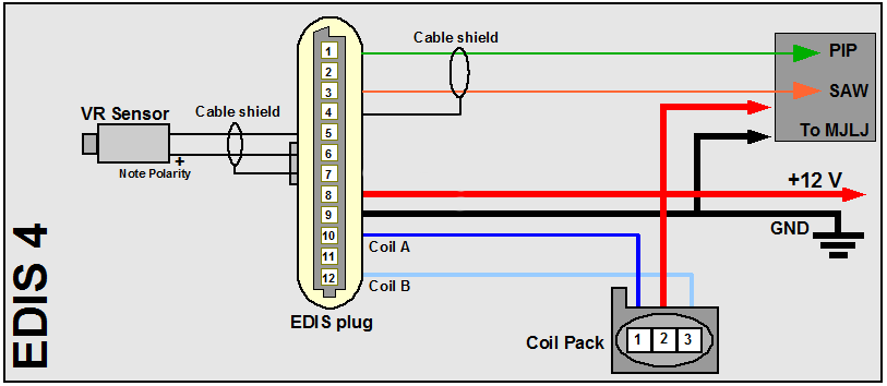

I'm currently waiting for my Megajolt kit to arrive here in England, for my Mini, and I've just been out to buy all the EDIS parts I need. I'm just looking over the wiring diagrams, and would like a few things clearing up! :)
I'm going to use 2 core shielded cable for the vr sensor, and the pip / saw wires. Now, I'm a touch unsure where and how these should be earthed / grounded. Am I right in thinking:
*The MJ and EDIS shields should all be grounded at the same point on the chassis?
*the VR sensor shield should only be grounded at the edis pin 7, not on the sensor end?
*On the shield coming from the pip / saw wires at the MJ end, should this be connected to ground?
I found this diagram, which has been modified by another member, is this accurate? (although I need to know about the shielding on the pip / saw MJ end)
Thanks, JJ :)
Is this accurate?
Is this accurate?
earthing poss.png (15.88 KiB) Viewed 9781 times

i allways connect the shielding to the EDIS module and nowhere else. workes without any problems

Thanks, this topic has just answered my question also. This is the first place I have seen the edis pin 4 wired as a shield for the pip + saw as this is how mine was wired when it arrived.Other diagrams only showed pin 7 shielding both pip/saw and vr. I can now carry on with installing the loom into my mini.
Thanks Again
Andy
Liverpool
Uk
Pin 4 and pin 7 are internally connected to pin 9(ground) in the EDIS module itself. At least they are on mine, verified with an ohmeter.

I run the set up in the diagram (It was me that posted it originally) for quite a while, with no problems.
I later fitted one of the Beta test rev limiter and modified it to power the coil pack from the MJ unit.
But still the earths are wired as shown, the actual connection is a ring terminal between the spaceframe and the EDIS heatsink I have fitted.
