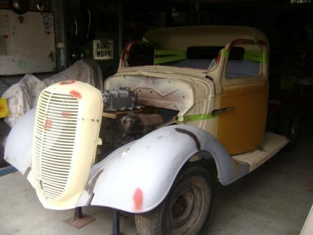

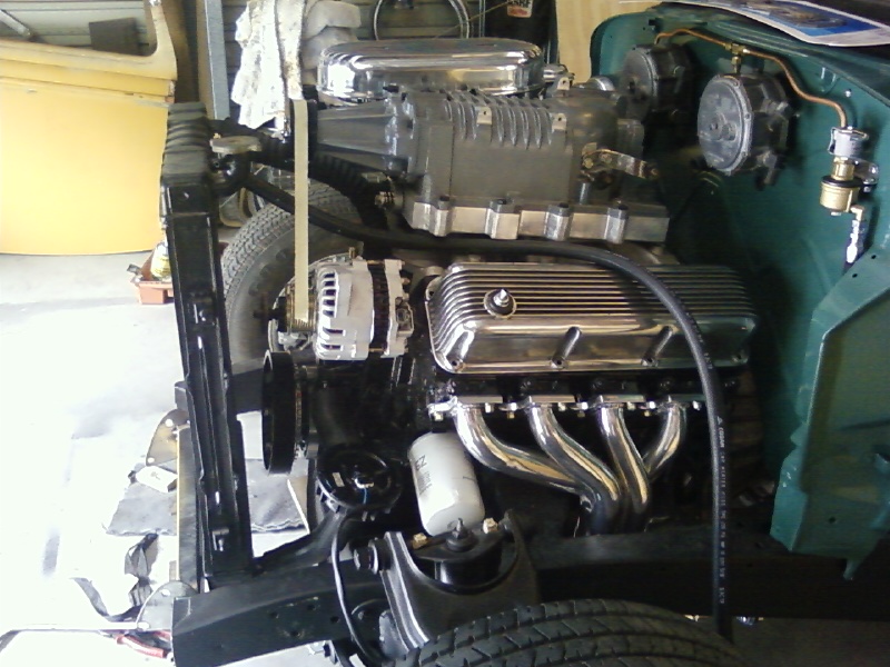

Hi all,
I'm building a 37 Pickup and thought I'd share some photos. The build includes, 351 Cleveland, Eaton M121, twin OHG LPG mixers, 75mm TB, BTR 4 speed OD electronic auto, Davis Craig electric water pump, MJLJ, 60mm section and 60mm top chop. At present it's in the mock up stage but here goes with some shots, I'll add others as they come along.
Rob
If anyone is particularly interested in some part of the build, I can put up some more shots of that part and comments.

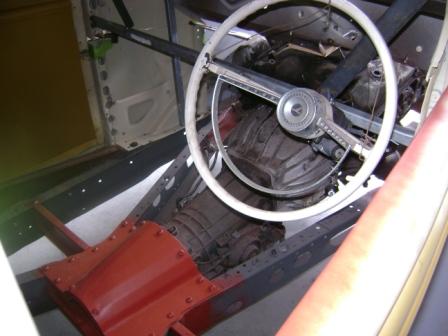

Inside, 4 speed auto, new x member.
Sectioned 60mm, chopped 60mm, 351 and Eaton M112
Chopped and Sectioned.JPG (33.7 KiB) Viewed 18371 times

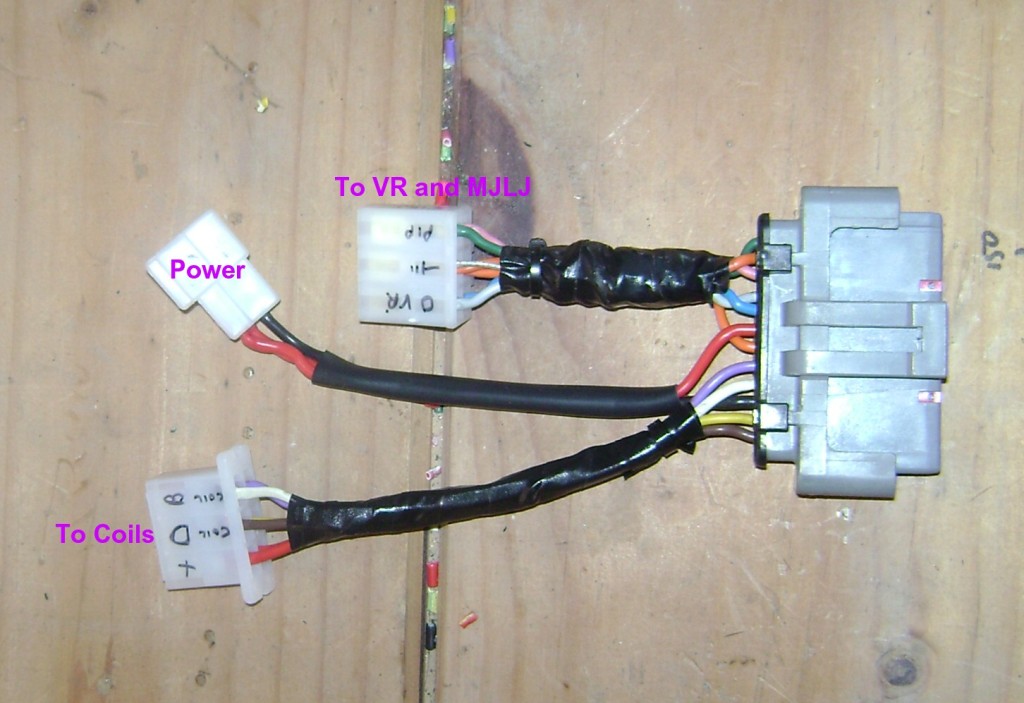

MJLJ wiring
MJLJ wiring

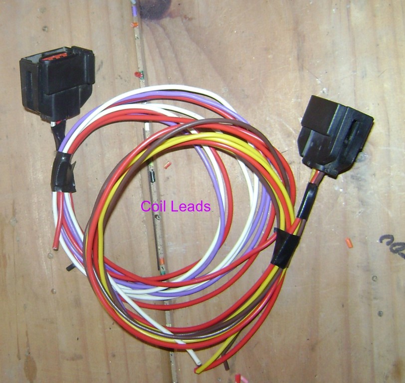

Coil wiring
Coil wiring

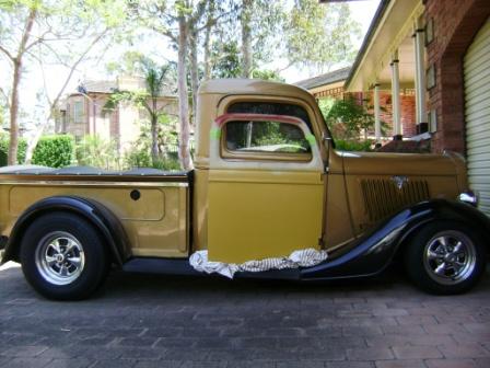

Chopped and sectioned door next to stock door, Ginger is my every day driver.

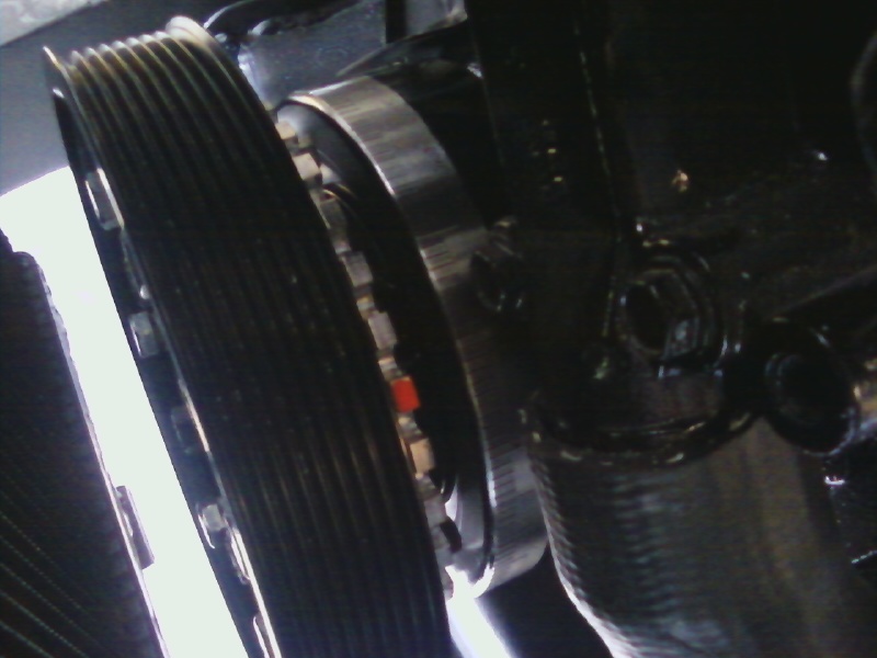

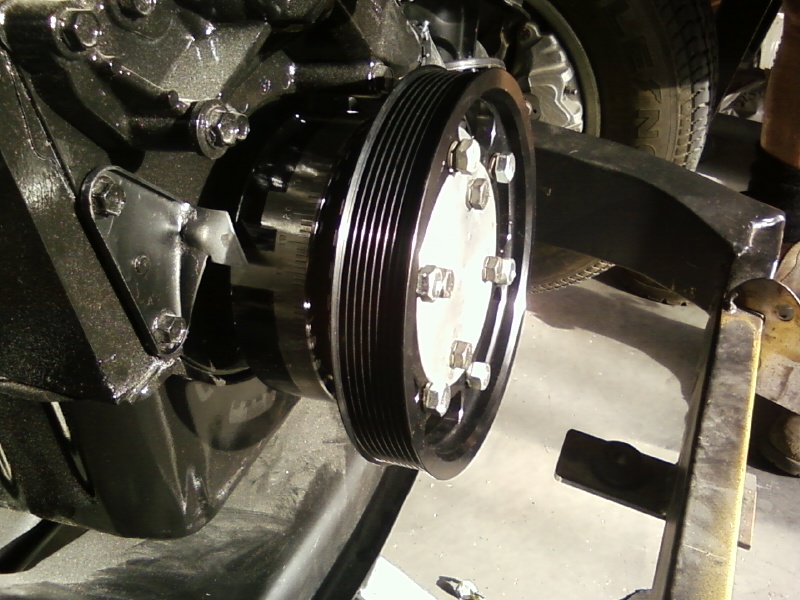

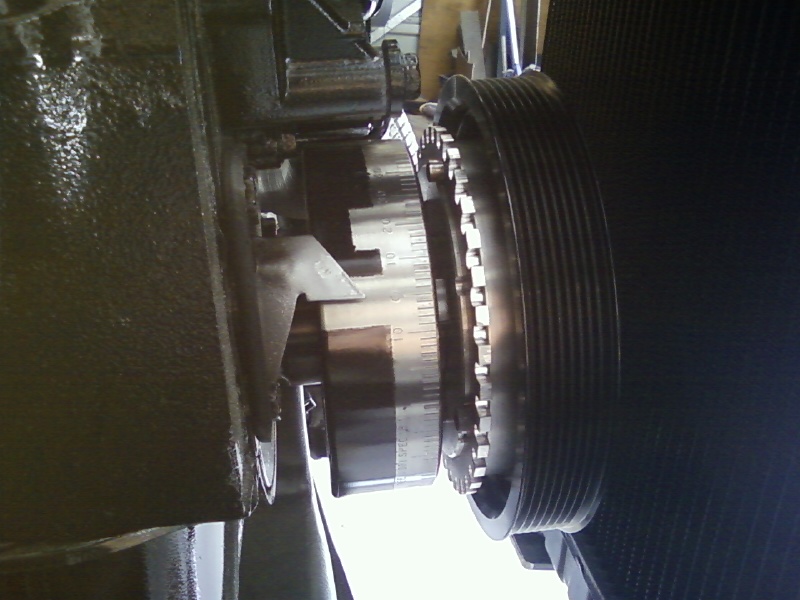

Hi all,
Some updated shots of the pickup.
Aluminium adapter holds 8 groove pulley and trigger wheel.

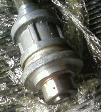

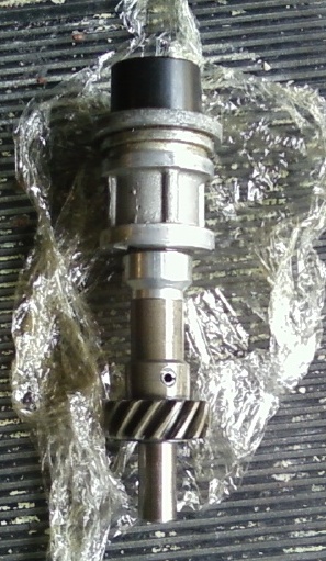

Modified Dizzy
Post by 37Pickup »
The dizzy was chopped of with about 15mm of shaft left protruding. A brass washer, steel ring and a roll pin were fitted to the shaft. The function of these is only to stop the dizzy falling to bits when you remove it. The black plastic cap is being replaced with an alloy cap next week.
