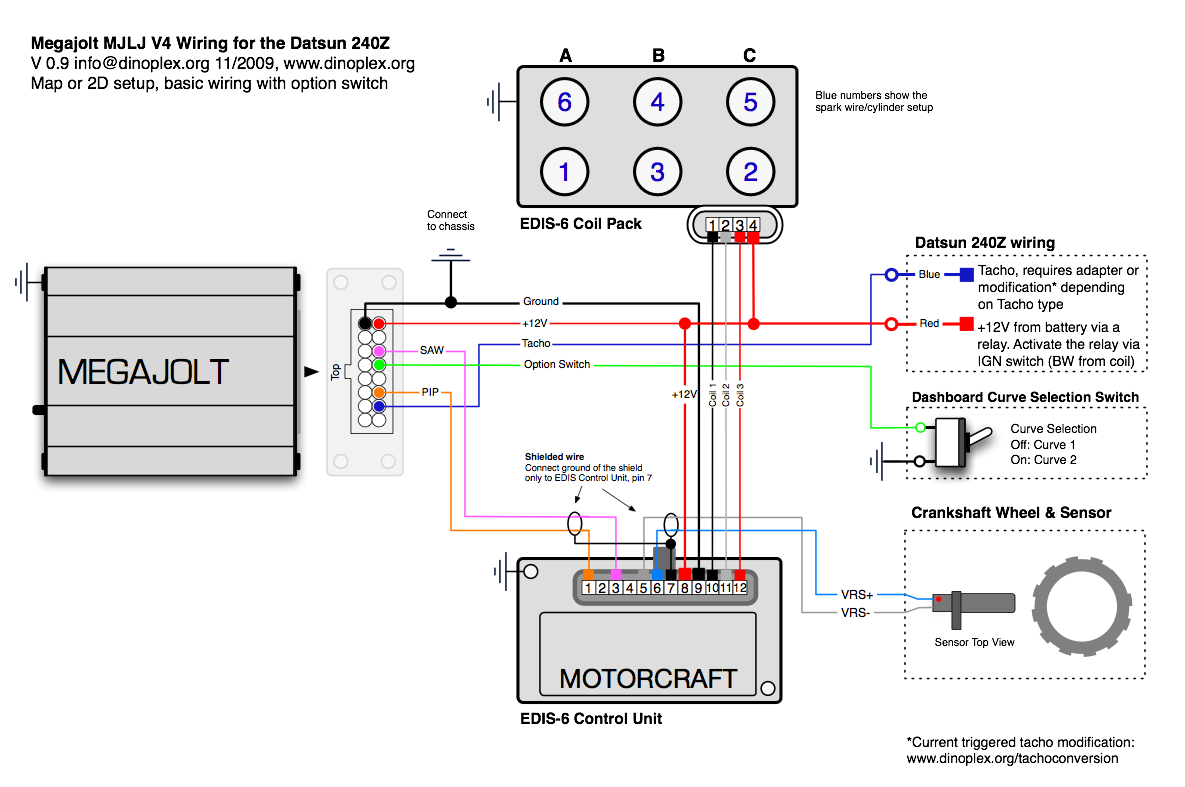

Here is the initial wiring diagram which i did for the documentation of my 240Z conversion to Megajolt. I thought it might be helpful to post it here before i finish the full documentation.
Datsun 240Z Megajolt Wiring Diagram
240Z Megajolt.png (153.39 KiB) Viewed 15522 times
Love that picture, vey neat. Is it possible to use it in the 'How To' section please???
Yes, will do! What drawing program are you using, by the way- is there a native file we can edit so we can illustrate the EDIS-4 and 8 setups?

Sure, you are welcome! I am using Omnigraffle Pro for such charts, its Mac OSX only though.
Let me know what you need and i can make changes and adaptions if you don't have a Mac.

Thanks for this. I can't wait to install everything and get my turbo setup going!!
