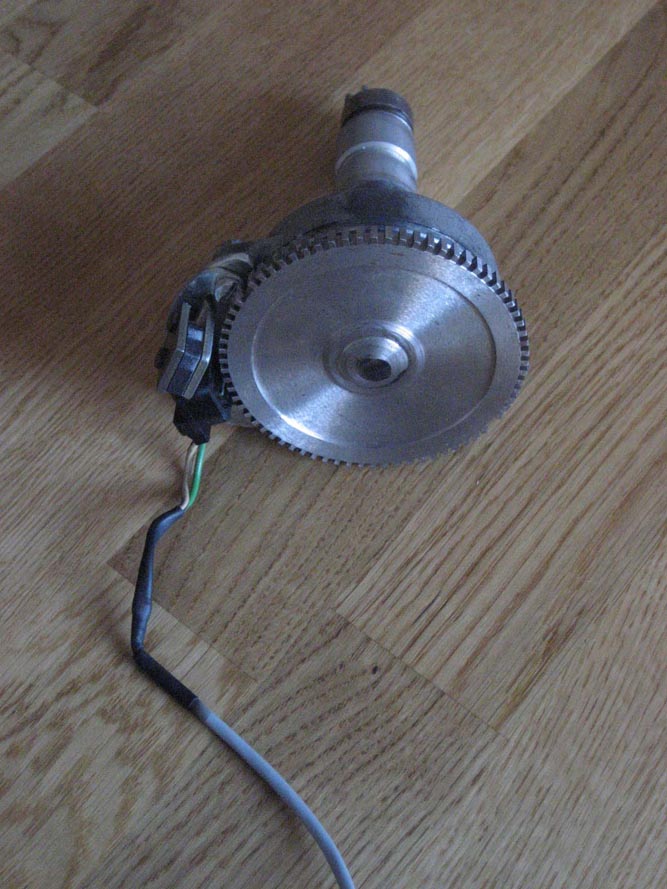

Trigger wheel for the MJLJ is a rebuilt dizzy with 72-2 wheel. Original sensor from the Ford EDIS couldn't read the small teeth - so instead a sensor from a Mazda RX-7 dizzy has been used.

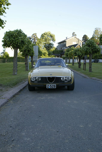

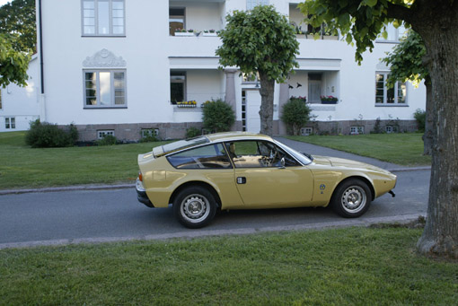

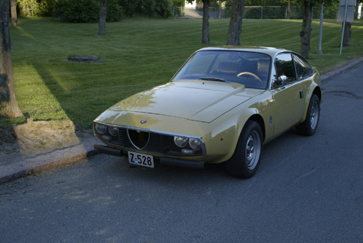

1970 Alfa Romeo Junior Zagato - sideview
1970 Alfa Romeo Junior Zagato - frontview

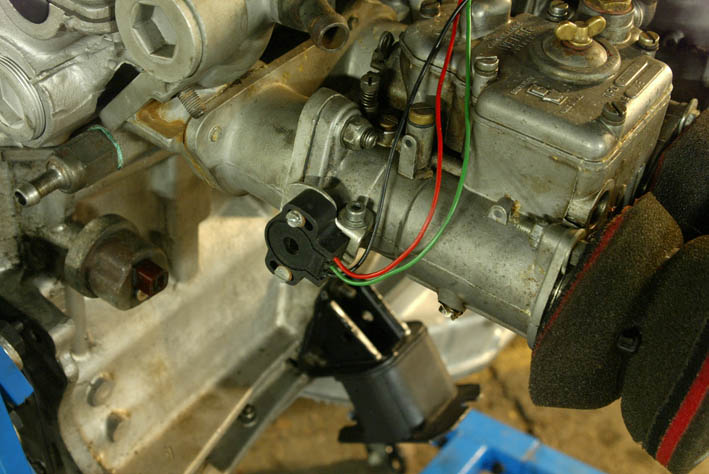

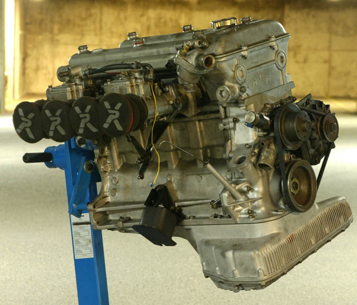

Some more pictures of the engine etc.
1750 Engine
1750 Engine
TPS sensor
TPS sensor
Converted dizzy to 72-2 wheel

Have you got a guard for that triggerwheel?? Otherwise you could have a finger like mine, lol. Checkout http://www.autosportlabs.org/viewtopic. ... 33&start=0 on the post from the 10 Nov

I haven't had a cover made yet. I'm trying different solutions. Since the wheel extends beyond the flat base under it - I have to conjure up something that allows it to sit securely at a distance from the wheel but still attached to the dizzy.
