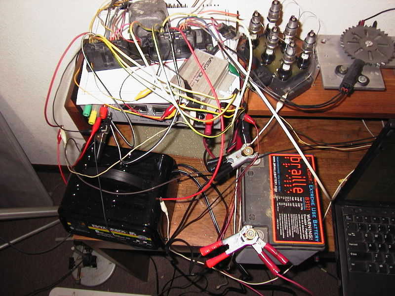

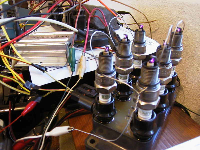

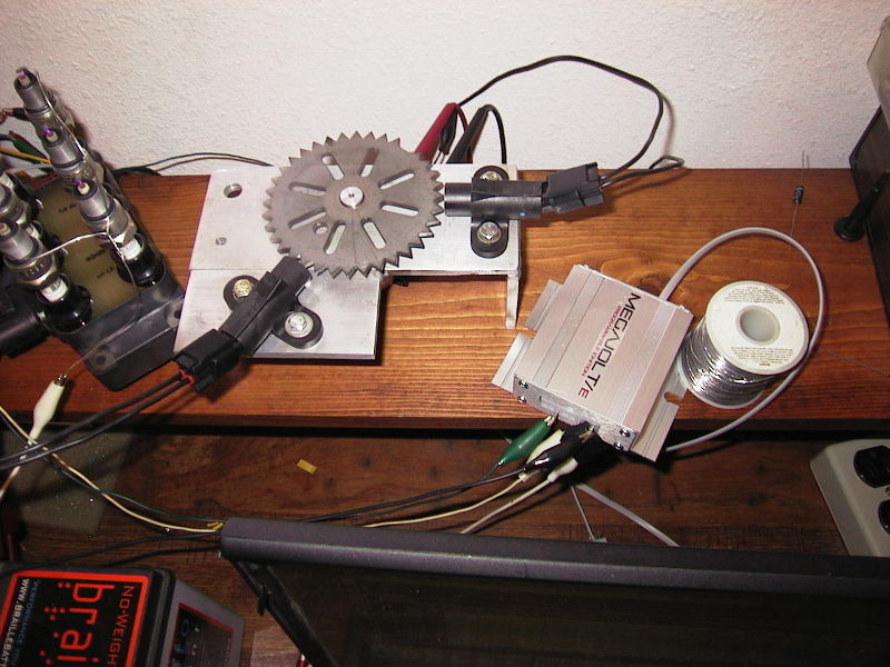

Here are a few pictures. Please excuse my rats nest test setup. The trigger wheel is spinning, the flash froze the image. Plug gaps are widened to over 1/8" to raise the secondary voltage to make it more difficult to fire the plugs.

Trigger wheel, two sensors, and one of the MJLJ.
Ign Sim Trig Wheel.JPG (98.37 KiB) Viewed 6847 times
Two EDIS, one of the MJLJ.
Ign Sim low res.JPG (76.02 KiB) Viewed 6847 times
Plugs firing
Plugs firing
Ign Sim Plugs Firing low res.JPG (67.85 KiB) Viewed 6847 times
