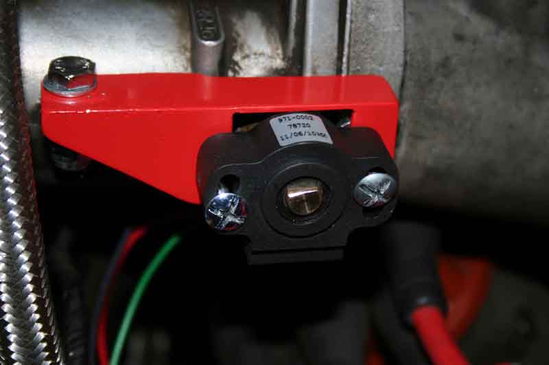

Found a map for my X-flow called 'aggressive', only changed cranking advance from 12 to 5. Strobelight shows that Megajolt masters the EDIS. I'll leave the VR-sensor bracket where it is, a test drive was concluent. The engine minimally moves and the sensor is almost in line with the momentum axis. The TPS bracket showed some trouble and I had to fix it differently to avoid too much friction with the throttle axis. Now the engine revs beautifully, starts easier, powerband is smoother a.s.o. Todo: connecting the rev counter, wiring the fuel pump to run as of cranking, adding an RJ11 socket to the dashboard...

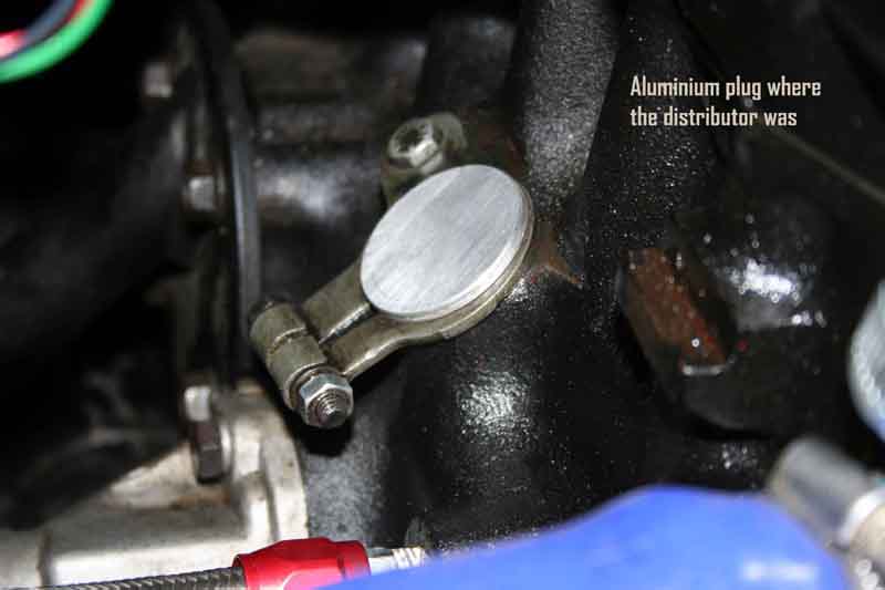

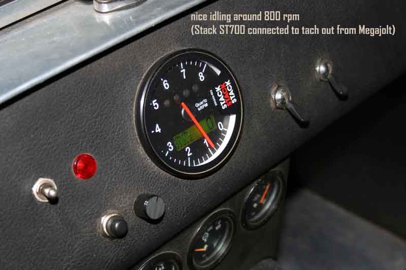

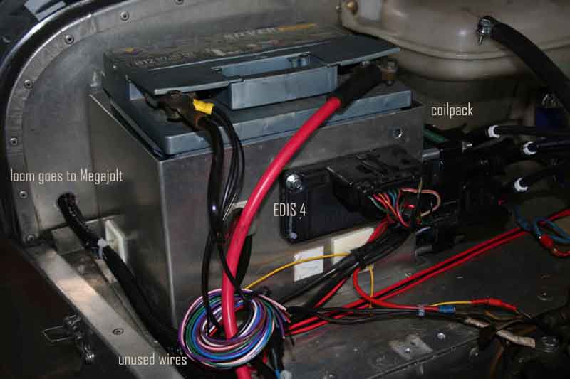

Today I connected the tach out to my Stack ST700 without any problem. Although I haven't tested a lot, I threw the dizzy out as well. My fear that this would be tricky because of the manifold proved to be unnecessary. The hole is covered by a nice aluminium plug from QED Motorsport. Weather still too bad for an extensive test drive. To do a.s.a.p. Pics of final installation added!
chassis brace came in handy

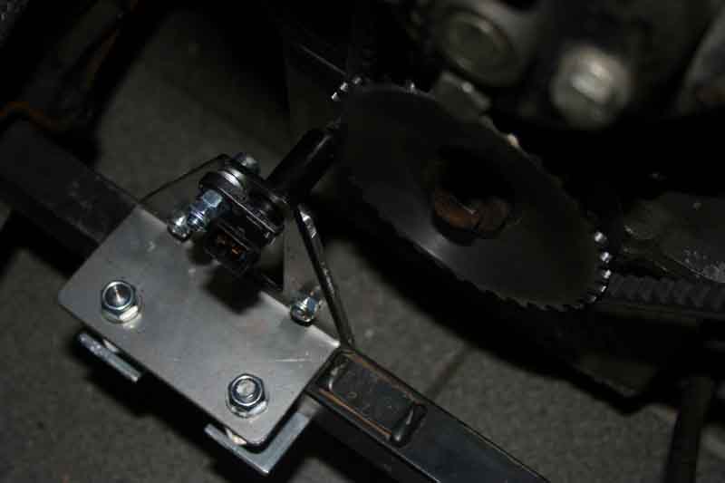

TPS ready for connection

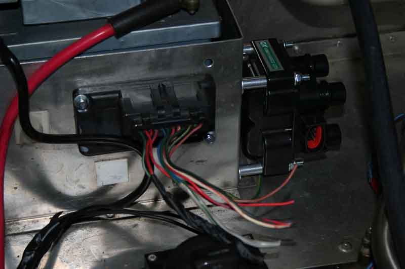

new home for EDIS and coilpack

In you last picture it looks like the VR sensor is chassis mounted. This will give you problems as the engine will move relative to the sensor, dropping the signal . You need to get it solidly mounted on the engine.

luxseven
Posts: 27
Joined: Mon Jan 31, 2011 9:21 am
Location: Luxembourg
Post by luxseven »
Thank you! I'll keep an eye on this during testing. In home limp mode and static 'in workshop situ', the engine doesn't seem to move as it is mounted on very hard blocks, but during a real run on the road, this may be different. If this alters the VR-signal, I will have to find another way to mount the sensor.

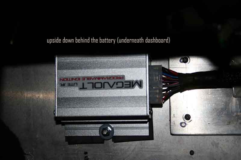

Pics of wired installation.
Cheers.
Jos
Megajolt behind battery tray inside the car... this gives nice short wiring.

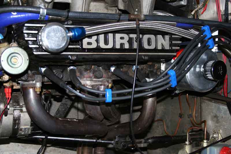

Goodbye dizzy!
Post by luxseven »
Dizzy no more... 8)
Cheers.
Jos
Lumenition cable clips give a nice touch.
