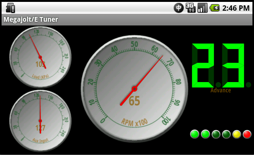

Here's a snapshot of what the runtime screen looks like. I'm still refining colors and layout but you can get a feel for what to expect.
A finger swipe will switch between this runtime view, the ignition map, 3D tuning, and datalogging.
- MegajoltE_tuner_runtime_preview1.png (129.72 KiB) Viewed 410113 times

Could I make a suggestion please... and it's excellent to see... but the sticky out bit on the needle is obscuring the numerals somewhat. Will there be an element of customisation available to choose a different needle set?
