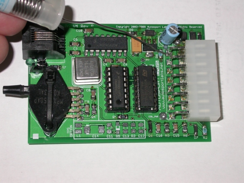

With engine running, we connected up the computer.... program opened but nothing - no rpm, no vacuum etc shown and the little green LED light on the MJLJ unit is off.
Checked the obvious power/ground connections and that the pins in the molex are seated properly - all OK.
The soldered connections on the board seem OK too, but I don't really know...
Can anyone give me a rundown of exactly how to check out the MJLJ board? It was working...

First thing you want to do is actually measure, using a meter, 12V into the power and ground connections into the Megajolt.
Can you verify power going to the Megajolt when the ignition is 'on' ?

Thank you Brent... I'll check the voltage where the molex pins are soldered into the printed board tomorrow.

Sure enough, when the various 12 Volt inputs were checked a bad connection on the upper side of the board was found while the under side still had a properly soldered joint. In the picture, I have shown exactly where the re-soldering was done. Power (green light) is on now, but the engine won't start correctly and after stuttering a few rpms, dies...
