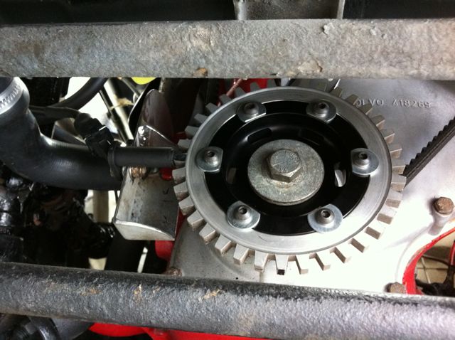

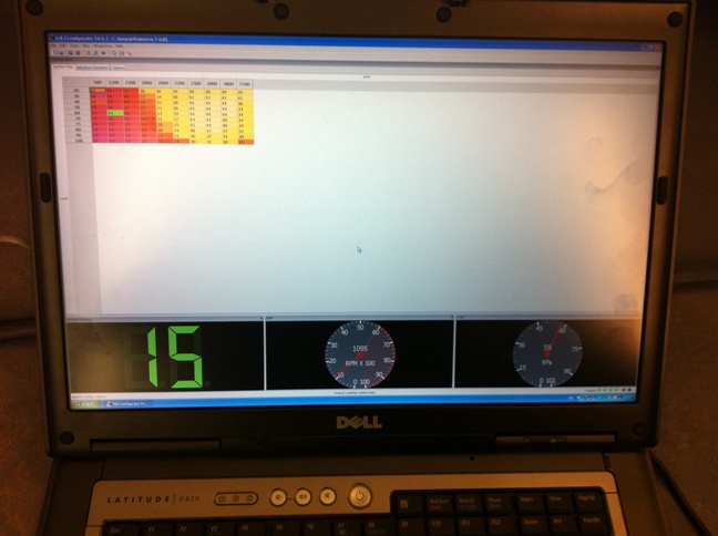

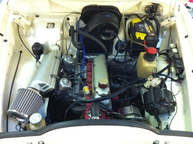

I installed the new ECU, hooked it up to my computer and they communicated straight away. I then ran the car without the MAP (manifold air pressure) side of things and she ran nice, checked it with the timing light and all was correct. So it was on to the MAP side of things; I took off the carbs and inlet manifold, drilled and tapped the inlet manifold to take the 1/8NPT hose barb for the vacuum hose which connects to the ECU. Connected the manifold and carbs back up, hooked in the MAP and fired her up again and all is working nicely. The revs and load show on the laptop readout and it shows me where in my ignition map the car is currently running. The car is more responsive and maybe it's my imagination but it does seem to rev better with the megajolt over the 123 dizzy.
After getting the car going fully on the megajolt I tidied up all the wiring including shortening the spark plug leads.
Quick overview of what was done:
- Installed a new trigger wheel and drive pulley
- Made a bracket for the VR sensor and fitted it 90 degrees anti-clockwise from the missing tooth with no. 1 piston at TDC.
- Welded the coilpack bracket onto the top of an old dizzy housing
- Wired everything up as per the instructions from trigger-wheels and auto-sport labs. I mainly used soldered connections with heatshrink.
- I don't have switched power from my fuse box that stays on when cranking so I had to wire in a relay that switches to a permanent power source when the starter-motor gets power to crank the engine.
- Wrote my map in the configurator program.

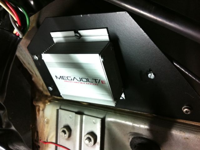

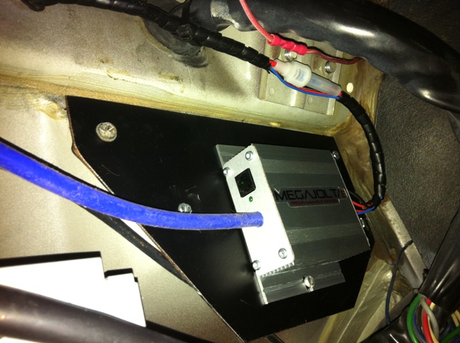

- Made a mounting plate for the ECU under the passenger side dash.
- wrapped all the wiring with electrical tape and then spiral binding.
That's pretty much all that was done. Apart from ECU issue and not realising that my power source stopped during cranking the install is pretty straight forward but there is a bit of work involved to get it done. Obviously if I had to do it again I'd do it in a 10th of the time.
I still need to paint the VR sensor and coilpack brakets and maybe a little fine tuning later on. I also fancy hooking up a rev gauge to the ECU and mounting to the bottom lip of the dash. Anyone recommend a nice retro looking rev counter that will work with the ECU output? Anyone thinking of installing megajolt I'd say go for it. Some pictures attached but will take some more detailed pics when I get back from holidays showing things more closely.
