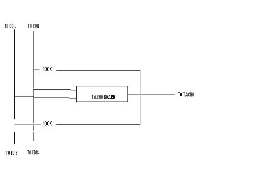

Abarth
Posts: 8
Joined: Thu Dec 08, 2011 8:03 pm
Post by Abarth »
I done like sheme attached.
Regads
cng1
Posts: 282
Post by cng1 »
That isn't actually what the schematic that Brent shared showed. His schematic had the resistors bypassing the tacho board in effect. You may find that trying it that way may work better.
www.trigger-wheels.com

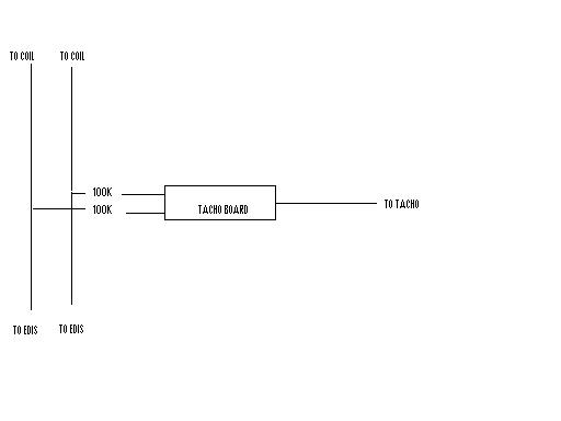

Abarth
Posts: 8
Post by Abarth »
Hello
My english is horrible. Can you modify my drawing showing how must install the resistors?
Regards
cng1
Posts: 282
Post by cng1 »
OK, here you go.

It works¡¡¡ Thanks a lot Chris and Brent.
Regards from Spain. :D
