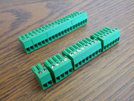

I ended up going with 2,4,8,6... but that could change once I get things set up.
I just got them this morning!

I see this wisdom in this "mod" because then the divided up terminal block roughly matches the grouping of the I/O terminals. It's not exactly clear to me how to replace the terminal block. Open the case and then it becomes obvious?
What about a DB20 or DB25 connector or some kind of automotive style header connector? I'm not looking forward to connecting and removing up to 20 individual wires with a tiny screwdriver, remembering which goes where and clamping down on the connections. So at the very least I'll be doing the terminal block mod, got to place an order with Mouser for some other stuff anyhow.
Thanks for the pics! Let us know how it works out.
GTIspirit - the terminal blocks are pluggable. They pull straight out from the back of the RaceCapture/Pro box.
We will likely never ever use computer-style DB25 connectors that require the user to solder wires onto miniature solder cups. At most we would use a Molex Mini-Fit connector like you see with our Megajolt project, where users would need to crimp / and or solder onto pins, then click them into the molex plug. But never say never, eh? :)
