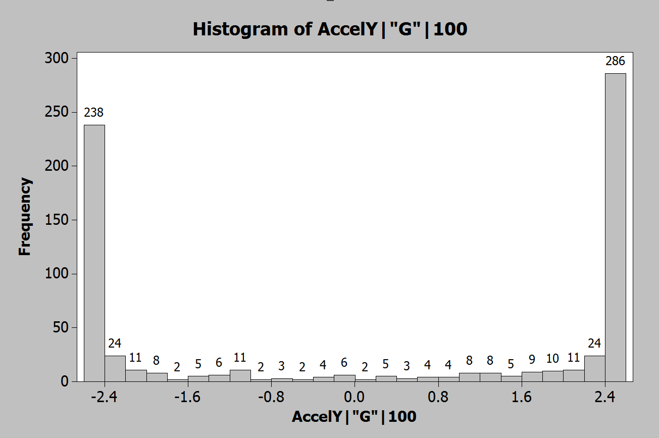

I think that it is virtually all noise. It just oscillates peak-to-peak. I think what we view as being a filtered signal is really just noise. If you look at the distribution of points its clear that a large majority are at the peaks of +/- 2.4gs

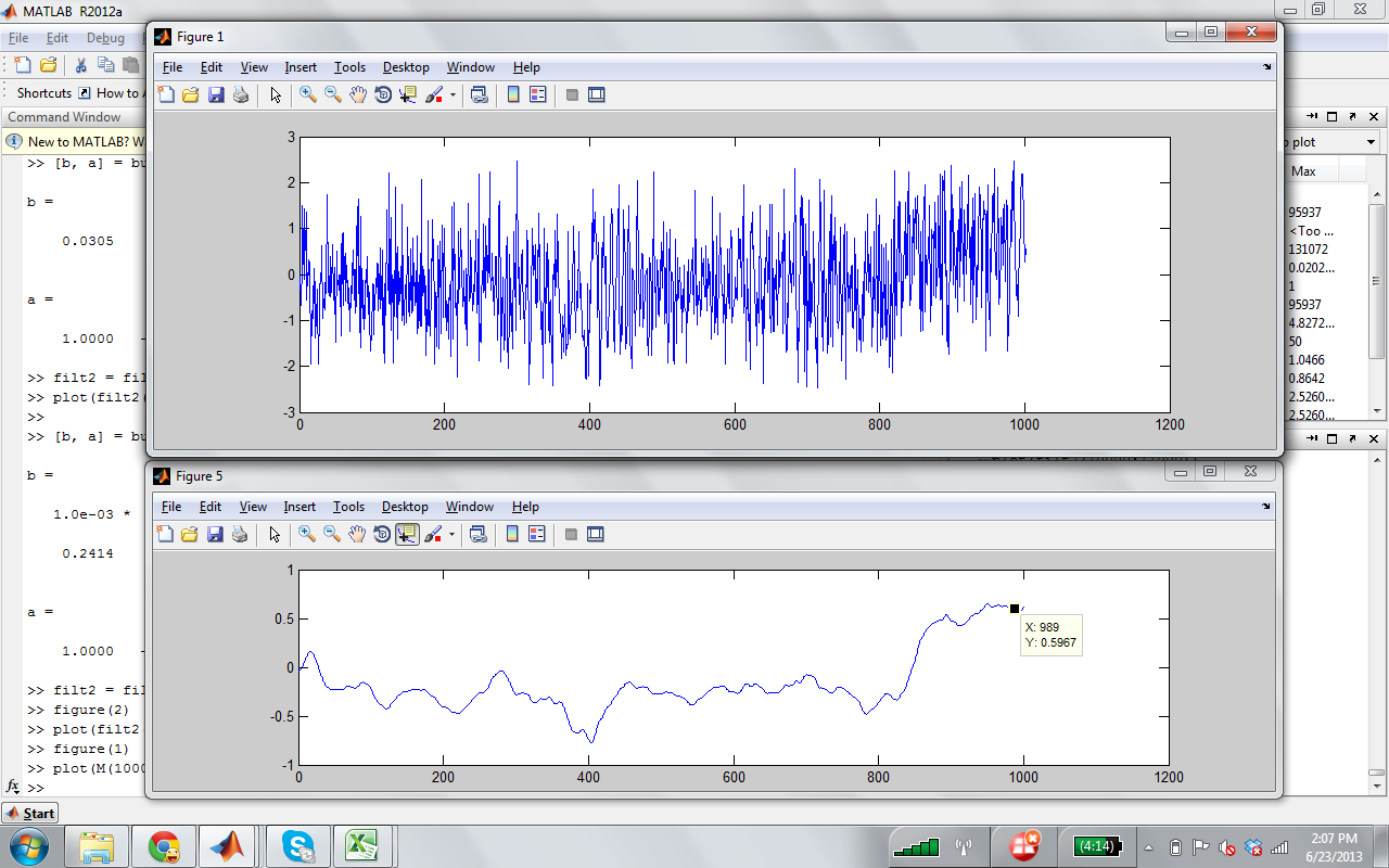

Success!
Installing vibration isolators on my kart made things better, but not necessarily awesome. The data was still very noisy, but at least it wasn't maxing out the accelerometer.
However, a simple moving average in excel wasn't cutting it. I decided to step up my game and pull out Matlab and doing some true filtering. I used a 2nd order low pass filter (actually a butterworth) with a cutoff frequency of 0.5Hz, and my data looks significantly better than it ever did before (see picture). I need to play around with the cutoff frequency, but this alone is close enough to truly get information from.
