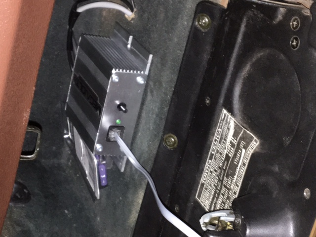

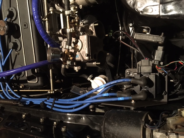

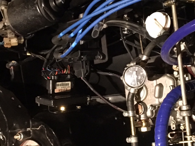

that's the max of 3 pics The edis and the coil are tucked nicely in the corner at strut tower and firewall. One note, that the coil is an aftermarket version of the Ford. It allows regular size wire boots to be used instead of custom made units with the OE large clip type. Cheap too at $20 (ebay or Amazon). Box is in the glove compartment. Sensor mount is a complete home made oddity that I'll post again. But it works.
Car is an 9 year continuous task that's nearly finished. MJ is working beautifully!!

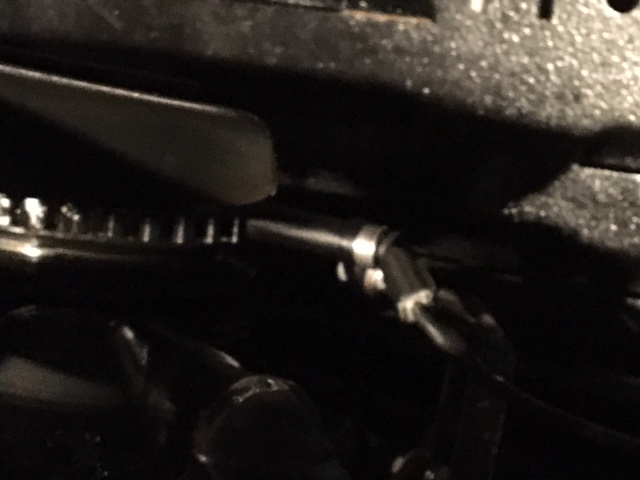

a few more for possible clarity
