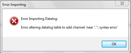

I got a failure with a more detailed error message, attached.
Try manually editing the log file to remove the '.' character in the oil pressure channel name. I think that's screwing up the program.
Error screenshot
Error screenshot

andylaurence
Posts: 43
Joined: Tue Apr 30, 2013 10:35 am
Post by andylaurence »
Good spot! So punctuation is not a good idea with channel names then. I've now been able to import all my logs by amending the channel name. Is there a way that this could be either limited when inputting the name of the channel or caught by some better error catching on the import script?
