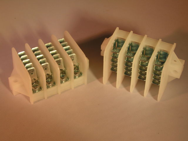

Can't I just cut into wire nice and neat using a terminal box like the below?
My megajolt and edis have inline fuse.

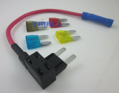

Also is it better to go into the fusebox and use a slot where it is empty using the below adaptor.
Image003 (3).jpg (43.9 KiB) Viewed 11853 times

I like that terminal buss adapter....where did you find it?
damunk
Posts: 65
Joined: Mon Aug 05, 2013 8:44 pm
Post by damunk »
tightwad wrote:I like that terminal buss adapter....where did you find it?
it's on ebay

The above adaptor lead works, getting power straight from the fuse box.

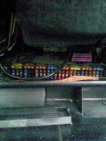

I have done a test 'tightwad'.
Not all of the fuse box loses power for that split second of cranking.
FUSES A) Only certain fuses that connect to the immobilizer go off and on. I HAVE NOT TRIED THE ECU FUSES
FUSES B) The permanent ones like lights, cigarette lighter, reg plate light stay on through the fuse box. With key "on" or off". They stay on from battery power.
Can someone help me in electrical terms about "relays"
Is it possible to have some sort of relay from FUSES A to FUSES B.?
Also shall I try the ECU fuse connections? I mean surely if they did not have 12v on cranking then the car would not work with its original ECU.
