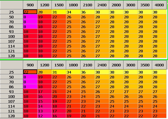

Map1 day to day, Map2 towing caravan or used if LPG bad batch. Basically knocked out about 5% at full boost. Also found by pulling idle down to 8deg i can get idle to drop a lot lower and stablises, stops hunting.
