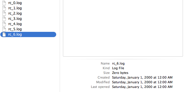

I put the RCP on the dash, managed to keep the Sat light flashing for a good long data record from beginning to end of the button push. Sadly the file is empty (see screen grab). Went back to my Lemons SD and half those files are zero K as well. Also sad to see that each test file I generated today has the exact same time and date stamp. Is this further evidence of my GPS problem or is it 1980 and my RCP is running a version of Apple DOS? Last night I updated my firmware to RaceCapture/Pro 1.2.3 successfully. Suggestions?

You don't have the code to stop logging if you aren't moving enabled, do you? What scripts are running in the Lua section?

no scripts running
Post by pricebill »
No Lua scripts.
Hi Bill, looks like the RJ11 jack on the RCP unit is likely faulty.
I think we have your email as well, we'll provide instructions so you can send it back to us for inspection.
Likely the problem is the tangs in the RJ11 are not engaging the RJ11 connector of the GPS module; they may be bent downwards. Take a peek at the connector if you're curious
Sorry for the inconvenience - we'll get this resolved asap!
