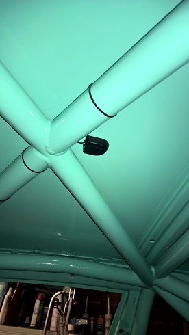

Possibly a daft question, but in a saloon car, could I magnetise it upside down on the inside of the roof skin? Is this going to significantly reduce the performance of the GPS reception?
I'm basically looking at a permanent(ish) installation into one car, and so was going to mount it to the inside of the roof skin behind the X in the roof bars, then route the harness around the cage and down to the RCP2 unit..

hopefully this explains what I am thinking a bit better...
Picture of inverted internal roof mount!
Ouch! that will not work at all. Antenna needs to point up towards the sky- mounted on the roof, for best performance. Glad we were able to clarify it!
