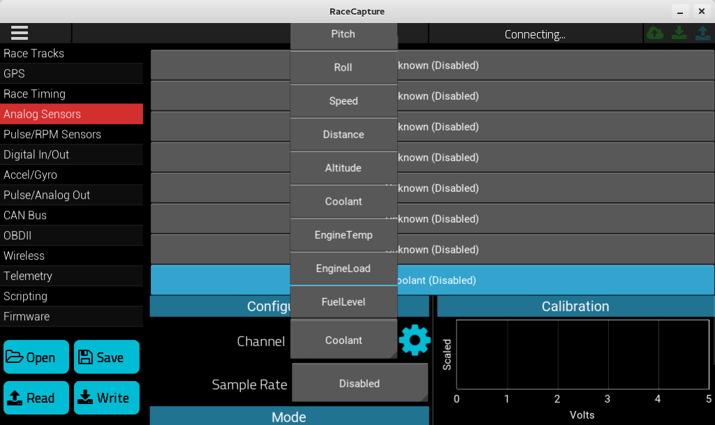

Hey All,
First post here, thanks in advance for any help.
We have a new RCP2 and are installing in the car for a test day tomorrow...
RCP has been configed via laptop... Cell telemerty is turned off (no sim card yet), blue tooth connected to nexus 7 tablet. Tablet dash configured, connected, and cloud upload working from the app.
1st question, when I log on and watch on race-capture account live, how do you configure the cloud info into gauges, etc? We would like to watch a few gauges like OP instead of have a map of where we are sitting, for example.
Also, we see activity at the left of the graphs, but no traces. Is because we are not actually moving? Is the bottom axis only distance? or can it be configured to be time?

Post by stieg »
When you configure the channels on the RCP unit, there are several choices for the Channel Name. By default the value is "Unknown" but if you change it to something that the measurement reflects (like "Coolant") then when you stream your data to RCL it will render a gauge for that channel. I attached a screen shot where you can set the Channel names.
It is because you are not moving. The bottom (or X axis) is only distance at this time.

Thanks Stieg!
I will more thoroughly install and setup correctly for this next test. It is that time thing!
