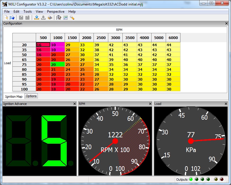

Over lunch I hooked up my laptop/configurator to the MJ. The map is still present, but when I fired her up I see that the actual timing advance figure (bottom right 'gauge') does not track the actual advance described in the map table... instead it is bouncing in the 5 to 7 degrees range.

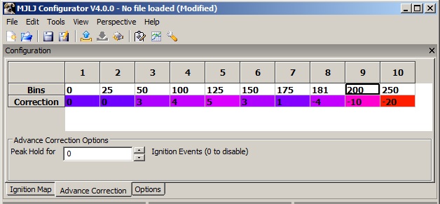

Turns out the Advance Correction data had been loaded with random garbage! Unfortunately I forgot to take a screen capture (pic below is what it should typically look like if good), but what I saw was that the correction values were large randoms such as -220, +44, -62, etc, plus the peak hold value was something up in the 37000 range. How that occurred I don't know (I've never touched that data in the past). Returning everything to zeros (i.e. disabling the advance correction) and everything is working OK again :)

Example of good data set (from operation manual)
