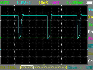

My first round of research told me to scope out the original signal, so I did. It is a 12V square with coil spikes that are (only guessing from memory) 70V. I figured to make a circuit with a zener diode to condition the signal to 5V. I drew the circuit me and a friend made. Please forgive the paint drawing, and my limited knowledge of all things electrical. I think I drew an accurate schematic.
The result we got was a decent square wave with very nice 5V peaks. However, the low point is now maybe 1.5V. The scope of the current signal is included. The device is still erratic, and it is not getting a good tach signal it seems. We added the second resistor pictured to give the diode a little more voltage & amperage. That seems to help (when we first plugged in the circuit, we weren't getting a signal at the device). However, I can't keep lowering the resistance because we're starting to get to where we might short the diode out soon.

Update: I got the CoilX installed and it still was not reading a signal. After using the scope, it seems is that it was dropping the signal at D2 diode. I tried to jumper it out, and it works! It is a little noisy from what I was looking at, it would be idling at 1200RPM then jump to 4800RPM and come back. I think the random multiple variables can be filtered out. I'll have to play with it after my next race, which unfortunately is a ways away.
