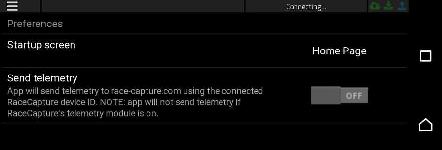

It should be possible to use the internet connection of the device running the RaceCapture App... though I did not used this function up to now but down below you can find a screenshot of the app showing the option you are asking for.
Telemetry via App.png (41.99 KiB) Viewed 3892 times

You can live-stream telemetry using the App, providing the app has an internet connection. You just need to set the telemetry device id (Provided by Podium http://podium.live) and then flipping the switch in the app preferences, as MikeD indicates.
