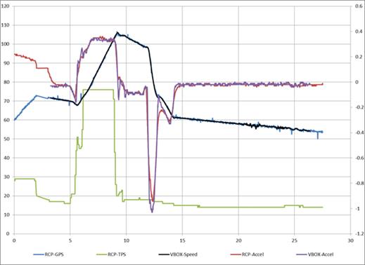

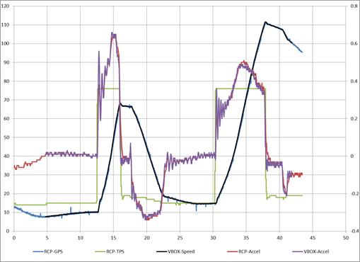

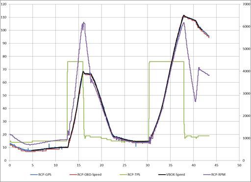

Hi guys,
I was working in a car manufacture and looking for a cheaper (but reliable) alternative for Vbox 3i in our performance tests. I stopped when I found the Autosport Labs´guys and the RaceCapture Pro MK2. Now I am becoming a dealer of their products and going to knock several car manufacture doors to show that they can spend much less money to have similar (or better) equipment for their tests, especially because they can connect anything and create any logic in RCP + send all the data using by mobile signal (good feature for durability tests)
Attached are some comparisons that I did by myself comparing RCP to Vbox 3i, using a Ford Falcon Turbo ( 270kW)
Cheers and congratulations to the Autosport Labs team.
