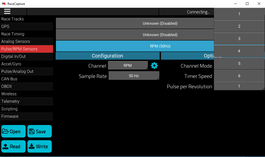

how did you do that? with the drop down menu that goes upto 30-50 (don't recall)

Go to the Pulse/RPM tab, then click on "Pulse per revolution" and i had to select 2, even though its a 4 cylinder. not sure why, but it worked!

interesting, my understanding that number was pulses per revolution. not the number of cylinders. I played with quite a few of those settings. I will check 6 again (bmw e30 with m52) and try again. thank you for the speedy replies.

if I put it on 1 it shows 660 at idle, the engine idles at 1300. At the limiter 6500 it shows 2700rom. Everytime I go up it splits the number in half.
Thanks. Looks like we need a "0.5" option for the divider. We'll file an issue to track this.

I believe so. We'll be adding the 0.5 pulse per revolution divider, which should address the 2x RPM that you're seeing.
