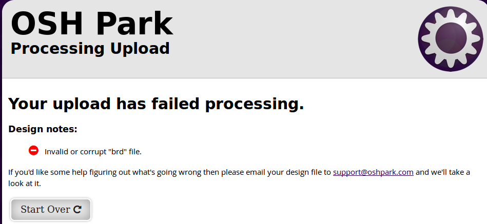

Uh oh, fault message on OSH Park :(
I downloaded the CANx.brd file (save link as) from GitHub and then tried to upload to OSH Park, this was the message which came back.
Sounds like the download was garbled. Try this:
* Go to: https://github.com/autosportlabs/CANx
* Press the green "Clone or Download" button on right
* Select the "Download zip" option.
You'll find the .brd file in there.
