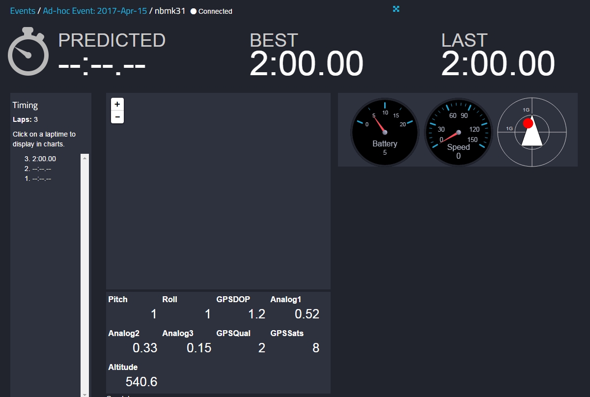

Ok I got over the sim card hurdles and now I have data streaming to podium.live.
I can see gages "battery" and "speed", and I can see numerical data for "analog1", "analog2", etc.
But how do I configure the podium webpage to show "analog1" and "analog2" as gages not numbers?
Podium How To Create Gages?
- MyPicture27.jpg (182.1 KiB) Viewed 2688 times
Round Gauges are automatically created and presented at the top for well-known channels matching the canonical list of channel names, which are also provided as pre-sets in the RaceCapture app's drop-down list.
Channels that don't match this list are presented as digital gauges in the area below. All channels are provided as charts as you scroll down the page.

If, say, Analog1 is really Oil Pressure, just name it to 'OilPress', write your configuration, and you'll see it show up on your Podium dashboard when you refresh the page.
Hope this helps!
