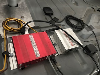

Here is my installation
unit
unit
Definitely a MK1 system. So to confirm, when you give it power, you don't see any LEDs on the system flashing?
