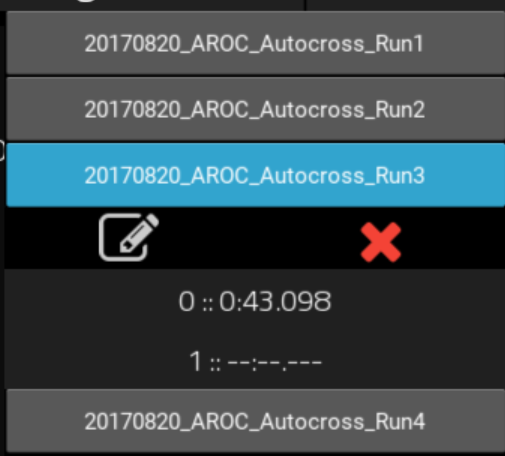

Just got around to installing Windows 10 on my Ubuntu machine, so now I can play with the RaceCapture app on my desktop computer. I thought this was possible, but I can't figure it out.
How to view / overlay multiple autocross runs to compare acceleration and speed? I imported four runs, but can't seem to show more than one. :( For us autocross people who have multiple log files from the same event, how do we compare them?
Hi, you should be able to select that one run from that session, and then go to the other session and then select the other run - the data should be shown together.

Ahh, thanks! I knew it was something easy which I was missing.
It also looks like after one channel is selected from one session, simply double clicking on the other sessions adds the same channel from those other sessions. :D
Right - because it assumes you want to compare the same channels across laps / sessions, which is usually the correct assumption. Glad you figured it out!
