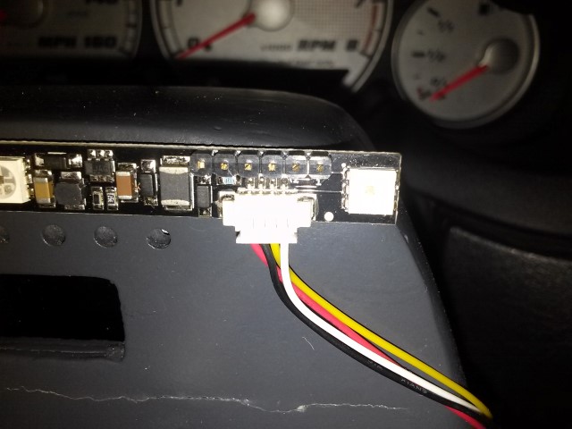

From left to right, the colors of the wires in the harness of my ShiftX2 are black, red, yellow and white. Looks like the black and red wires are inverted. Can you confirm the board pinout, from left to right, not considering the wire colors?

Here is mine. It is wired according to the install here: https://wiki.autosportlabs.com/ShiftX2
If the color code does not match what's documented then it seems your wiring harness was manufactured incorrectly, sorry for the inconvenience!
I clarified the documentation here:
https://wiki.autosportlabs.com/ShiftX2#Pinout

Thanks, guys. I know it sounds obvious, but I wanted to be sure, so I won't fry anything.
