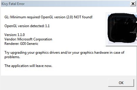

when started in safemode it shows the openGL problem .

It sounds like you are testing the Beta 1.12.0 release. This release does not have the fix for the Windows 7 crashing problem with certain graphics hardware (Intel HD graphics 4000).
We are still investigating it and will likely fix it in the 1.12.1 official release.
Note: The change log will show all of the fixes and improvements; when we do fix that specific issue, it will show in that list.
