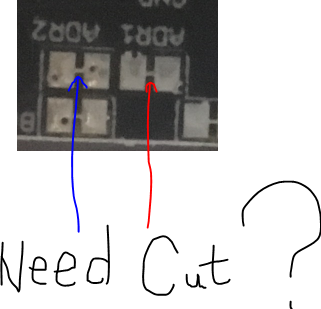

Need to cut the bridge each ADR?
How do i cut them?
Hi, we have a chart here that shows how to configure the base address, with instructions on how to cut.
https://wiki.autosportlabs.com/AnalogX#CAN_base_ID
