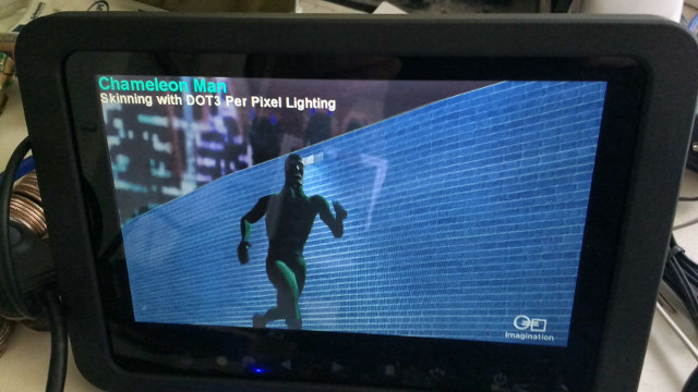

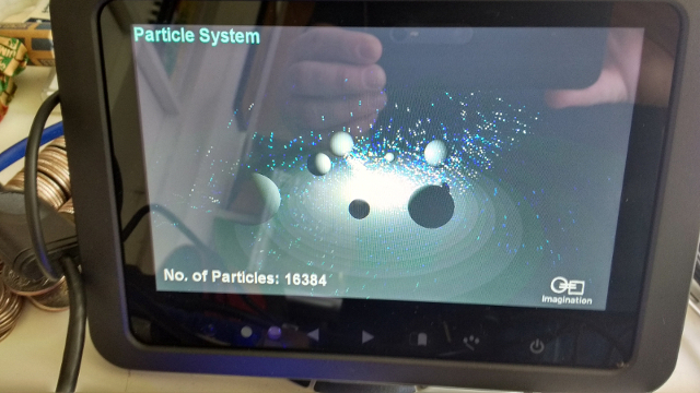

I have been traveling for a few days, so not as much progress as I would like. But some progress:
  • Got some accelerated demos working in the stock debian distribution
  • Got first working buildroot config which boots, and allows ssh login
  • Got the QT5 Opengl Demos to run with acceleration
  • Got Kivy building under buildroot, against the platform GLESv2 libs.

One thing that's really nice about buildroot his how fast these images boot, even off an SD card.
Attaching images of the demo apps. The apparent dithering is actually an artifact of my cell phone camera and / or compression, not apparent in real life.
