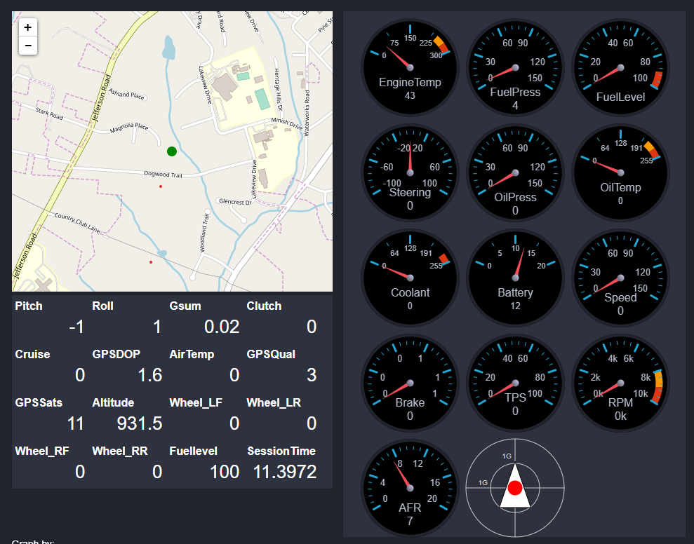

Having similar issue. Using RaceCapture/Pro MK2 latest firmware update 2.17.4. Using Bluetooth adapter with Android Dash. When logging into Podium.Live there are Gauges present that I do not have sensors for, is there a way to remove unused gauges? I also have a custom Analog Fuellevel sensor that does not show.

RBR Rash Dash PodiumLive.png (216.61 KiB) Viewed 12735 times

Post by mbulls »
Brent,
Any insight on this as well as not being able to change the default FuelLevel Channel. No matter what I do it will not change from Liters to a Percentage and does not read the Analog port. I can create a new Channel and even name it the same FuelLevel and it does not work. If I create a new one and name it Fuellevel (lower case l)it works fine but does not display as a gauge in Podium.Live.
