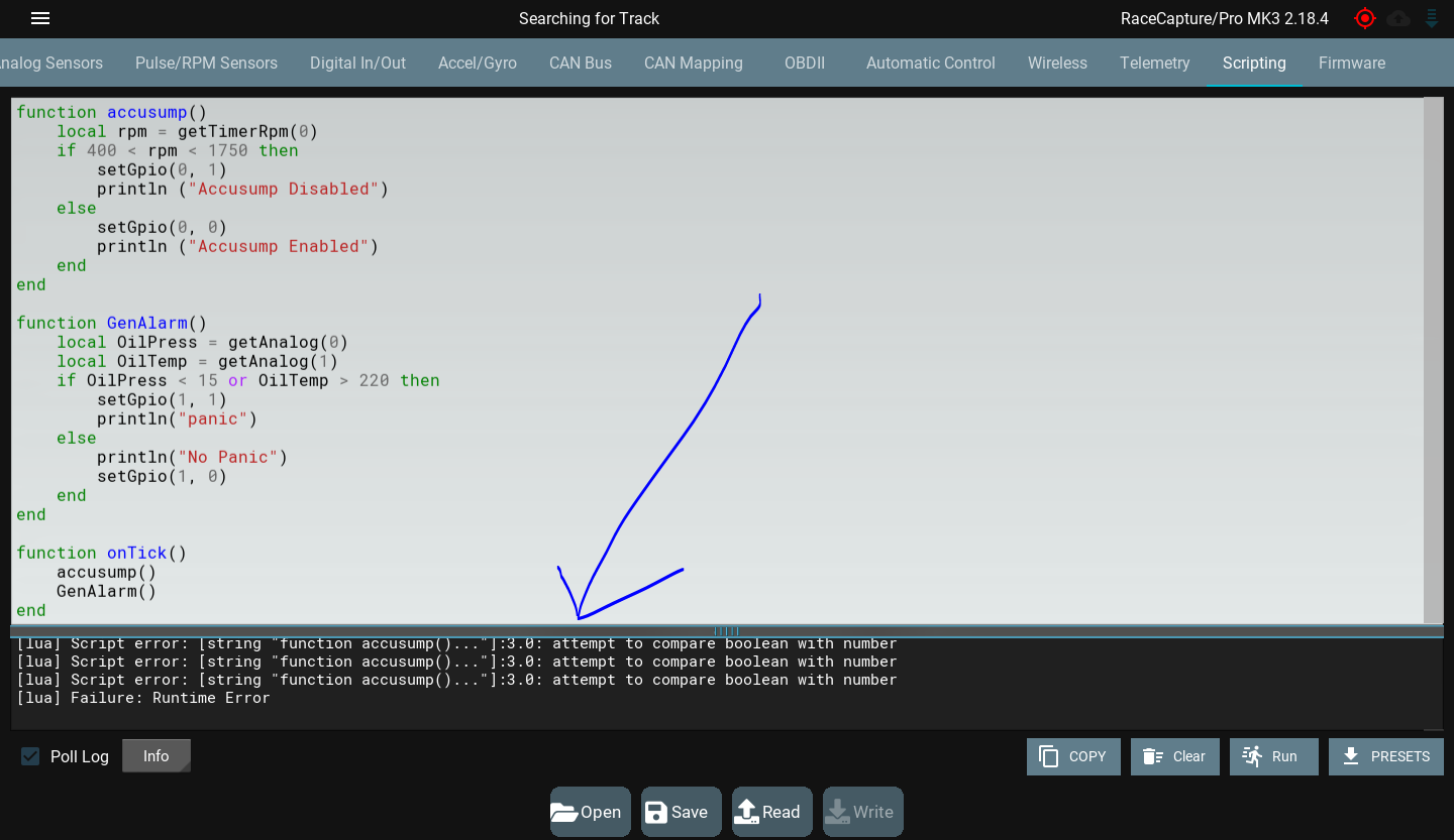

I'm hoping someone can take quick look at the simple scripts I'm trying to run on my racecapture pro v3.
Basically I have the three GPIOs set to output mode and connected to a relay board. The intent of my scripts are just to cycle normally open and normally closed relays based on measured values. Seems really simple, and I looked at plenty of examples, but still can't get mine to work correctly.
I'm sure I'm just missing some basic syntax... this is definitely not my wheelhouse.
Error code when running the following script:
Script error: [string "function accusump()..."]:3.0: attempt to compare boolean with number
lua script woes.PNG (114 KiB) Viewed 10688 times
