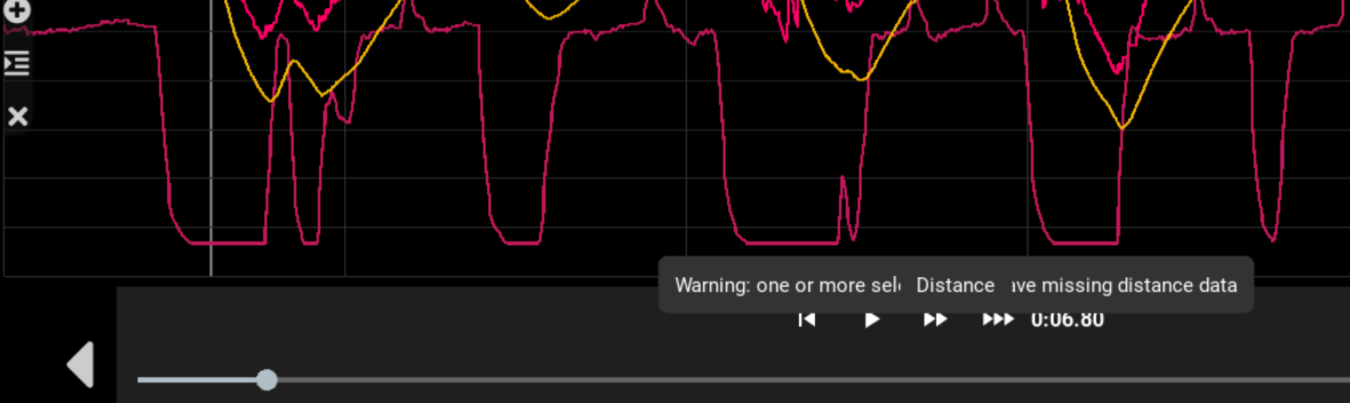

I'm looking for a clue to a following problem: on one of the cars where I have RaceCapture installed, the following message appears when I switch on the distance based-graph ("Warning. One or more of the selected laps have missing distance data").
However, the graph is still plotted and as per my understanding — distance data is present in the log.
Could you please advise, what does it mean and how it can be fixed?
App saying "laps missing distance"

This happens if the lap has distance that does not increment across the lap above a certain threshold.
Try adding a distance channel to the plot, and see how much distance changes over time across the lap.
You can also try the lap recalculation feature as described here: https://www.autosportlabs.com/racecaptu ... s-release/
Failing that, you can zip up your log file and we can review it as well.
