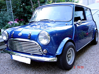

project 1380 cc mini.
With a 7 head ports and more ....
Mini Se7en
Mini Se7en

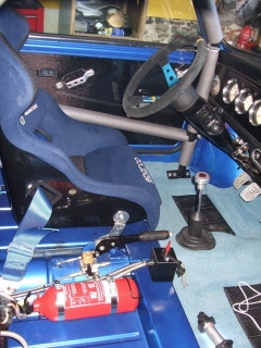

Rear Anti-roll bar
Ajustable rear camber
Adjustable Tie and arms
4 kad engine steadies (top and botom)
Hardy spicer drive shafts
4 diff pins

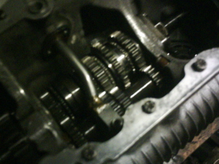

Sc gears box and drop gears ( 3,76 & 1,0897 = 4,09 final ratio)

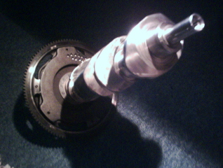

Crank and flywheel light and balanced, polish, conrods too
286 kent camshaft
duplex adjustable timing gear
73, 5 pistons 9 cc dish

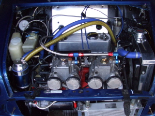

7 head ports 19 cc chambers with kent double springs and titanium valve spring retainer
Weber DCOE 40 mm
ARP studs kits ans main strap
1,3 roller rocker
Alloy radiator
Oil radiator
4 pots calipers and drums (all alloy)
All braided hoses inisde the car with Ap racing adjustable brake bias
6 points roll cage
Sparco Seat and harnes
Carbon dash, pannels and box battery
Electric fuel pump with braided hose inisde the car (omp extringuisher), King pressure regulator
LCB manifolt and pipe and exhaust all in stainless and carbon (rear silencer)
knock phormula sensor
LC1 innovate lambda sensor
OMP steering wheel
Quick shift lever
and more details ...

http://britishminicorp.chez-alice.fr/firststart.mp4
first start. it runs great. Map is published in the library
