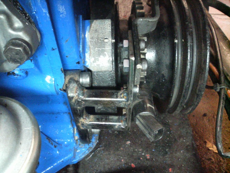

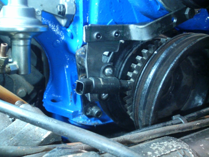

enter MJLJ.. as the front end was all apart anyway for the cam change, we fitted the trigger wheel and sensor...
mjlj sensor
mjlj sensor
Image1378 [800x600].jpg (139.22 KiB) Viewed 14638 times
mjlj sensor1
mjlj sensor1
Image1376 [800x600].jpg (175.41 KiB) Viewed 14651 times

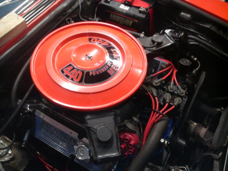

we arranged the coils packs on the pad that did support the air con, but as this needed a major overhaul, and never worked anyway, it was used to mount the coils! and it made the cableing of the plug leads nice and neat!
engine
engine
Image1448 [800x600].jpg (130.55 KiB) Viewed 14647 times

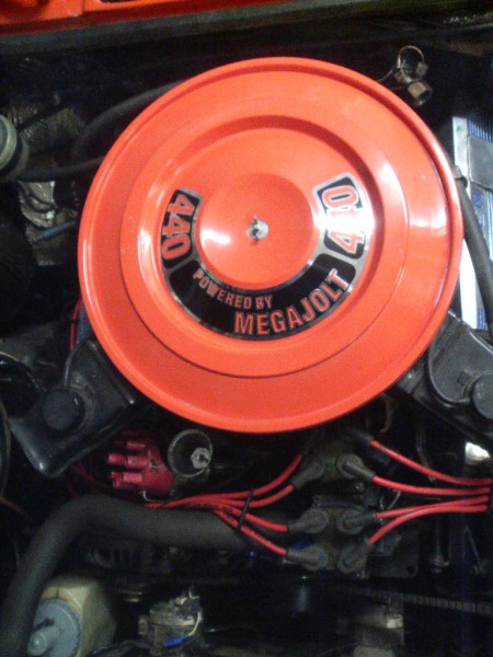

i also knocked up an appropriate air cleaner decal, as it was a little plain!
air cleaner
air cleaner
Image1450 [800x600].jpg (89.12 KiB) Viewed 14646 times
