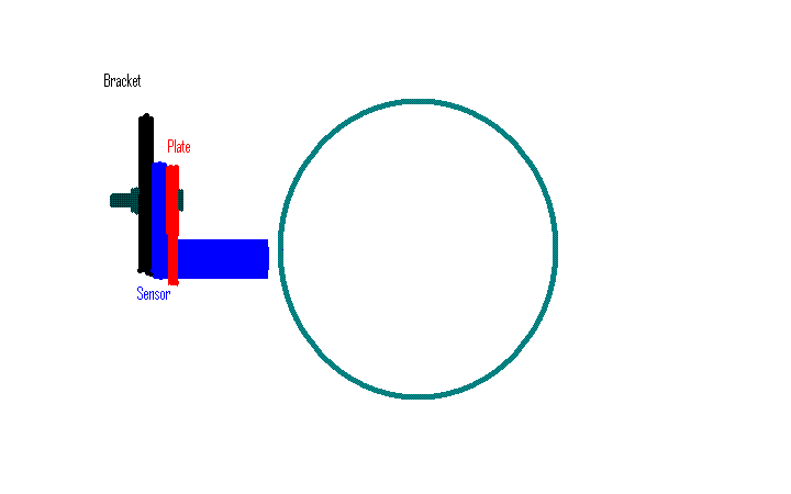

I would say its a clamp to spread the pressure of the bolt.
So it goes like the poor Paint picture attached

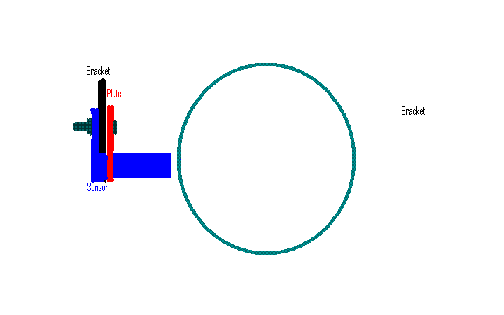

Or if thats too far forward try this way
Ken555
Posts: 92
Location: Aberdeenshire
Post by Ken555 »
Knew I had seen that type of setup before somewhere.
So the 2nd diagram is correct. Here's a photo of the assembly
So its sensor/bracket/plate
The sensor can be spaced backwards with a washer if needed.

Spoke to the guy who produces these & you're exactly right, the bottom picture is how he described it, you use the washers to get the gap correct.
