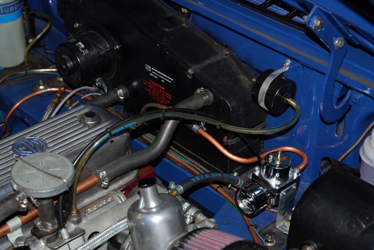

some pics of my install... 1965 MGB +40 18V block reworked big valve cylinder head, Nissan 280ZX 5 speed..
completed June 2010
This is a MAP type installation.
The ignition map I used came from the 'how it was done section"
so far I haven't modified it because the car runs so well. starts from cold in a few turns, and from hot the same..
Th car pulls hard through the gears and idles dead smooth!

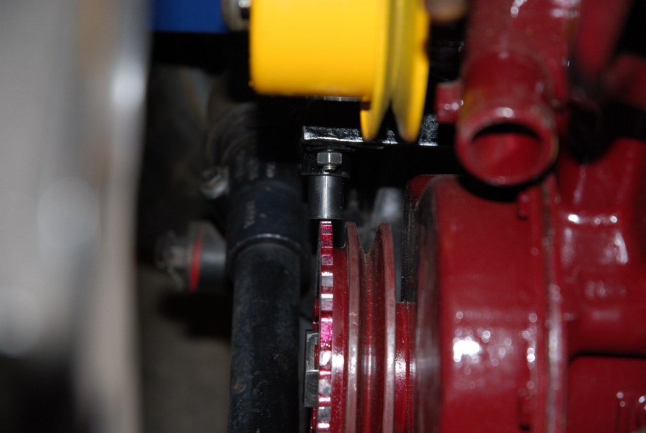

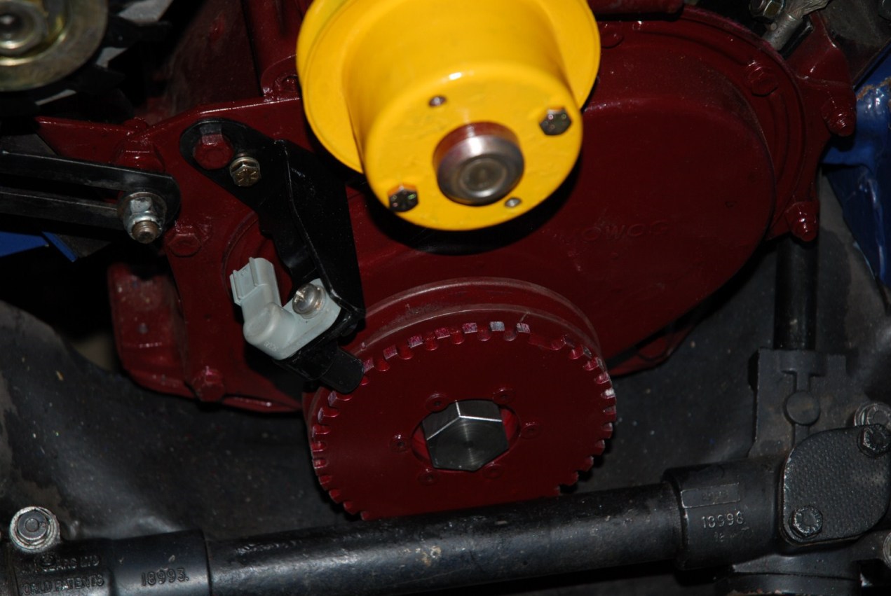

The trigger wheel came from triggerwheels.com and it was for a A series engine. I milled the adapter so it sits 2 thou out from the pulley and I milled the pulley down to ensure the sensor reads properly.. the next one I do will simply be a larger trigger wheel...( 6 inches) so the pulley will remain standard.
There is a lot of theory that the damper shouldn't be modified, but so far I don't notice any negative vibrations etc.
The sensor is from a 2000 Ford Taurus.
I spend about 400 Cnd dollars in the install.
Sensor install with a custom pulley bolt

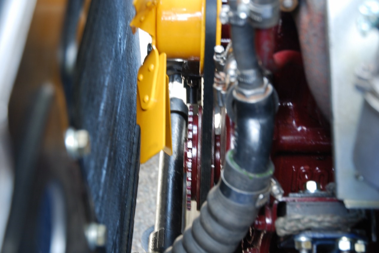

sensor install -  the fan belt is a fiddle to get between the rack and the wheel.. but it can be done

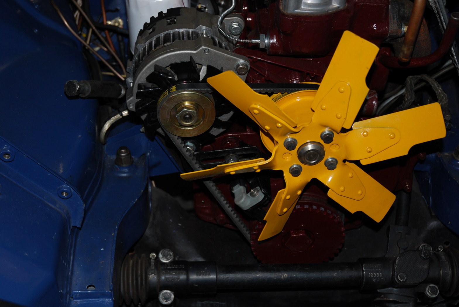

sensor install
sensor install

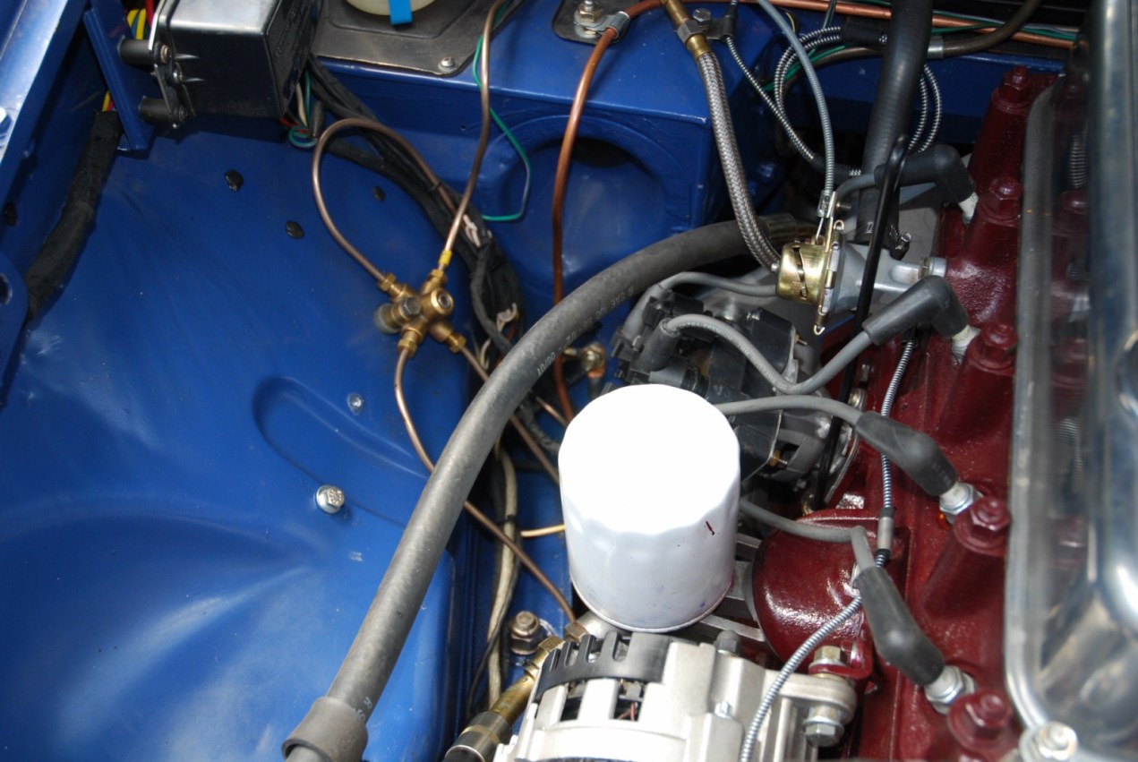

Coil.. screwed to an old Lucas distributor cut down to size  1st glance looks stock.

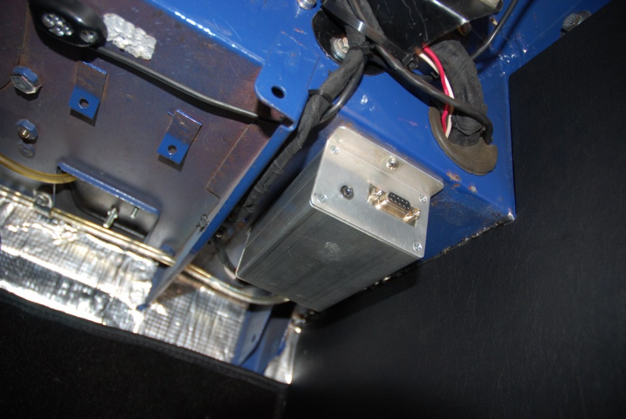

megajolt installed under dash with added blue LED to indicate power

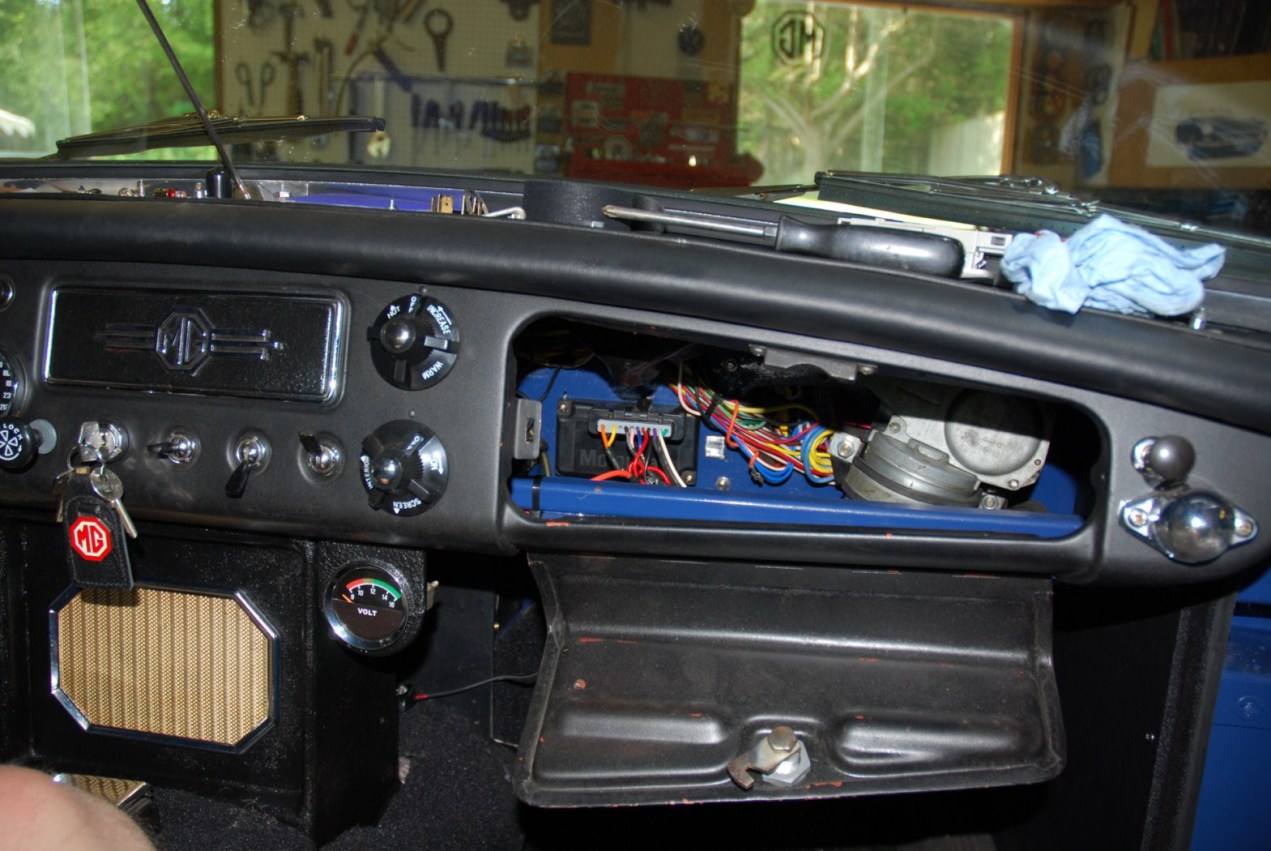

EDIS module installed behind glovebox
40 CC Vaccum stabilizer capsule made from two built in Vacuum cleaner ends..  PVC
